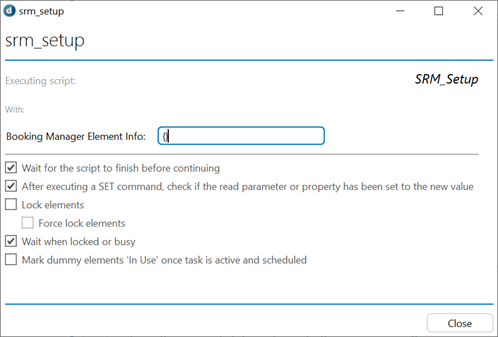

Go to Automation module in DataMiner Cube and select the SRM_Setup automation script.
In the lower-right corner, select Execute.
In the Booking Manager Element Info box, specify the value
{}.Click Execute now.
If the script execution fails, wait a few minutes and try again. If the problem persists, contact Skyline Communications.
The script will configure the framework and create all relevant components to get started with the development of a process.
