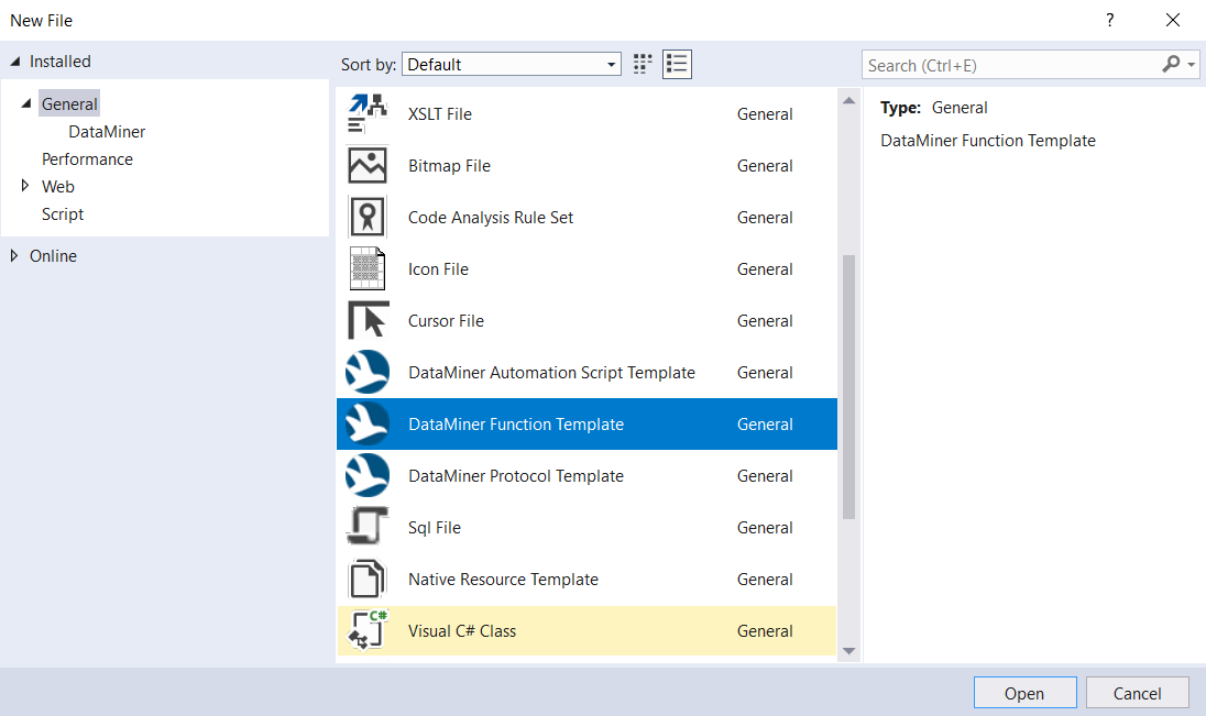

  1. Open Visual Studio (with DataMiner Integration Studio installed).
  2. In the header menu, select File > New File > XML File.

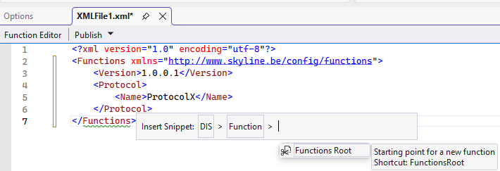

  3. Press Ctrl + K + X, and navigate to the DIS Function Root snippet available under DIS > Function.
    DIS Function Root Snippet

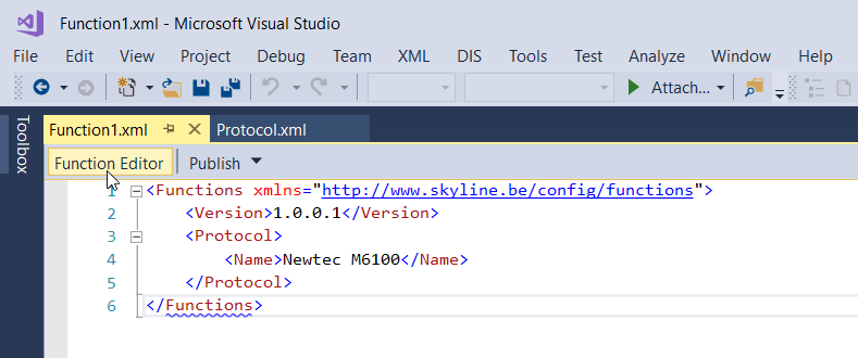

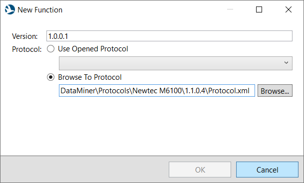

  4. Add the connector name in the Protocol tag.
  5. At the top of the code editor, click Function Editor.
    If the connector is not opened, you will be prompted to open it.
    See also: Function editor

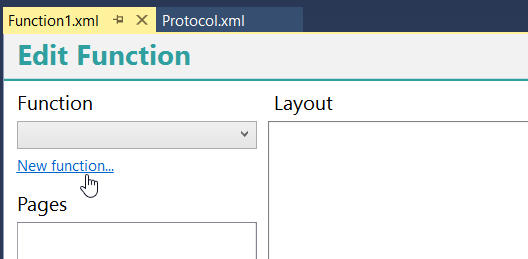

  6. Click New function to start creating a new function.
    New Function option in Function editor

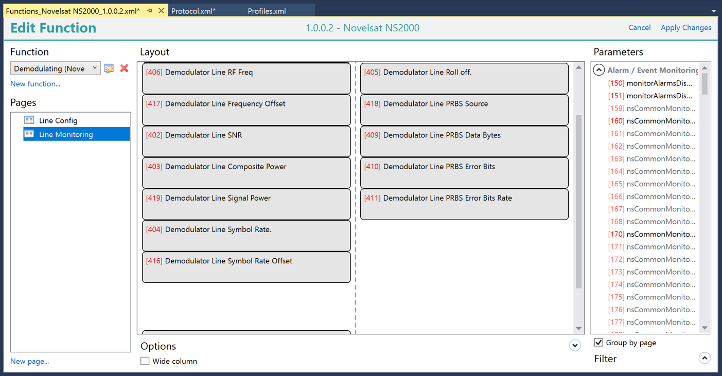

  7. In the Edit Function window:
    • Specify the name of the function (e.g., decoding).
    • In the Profile box, select the profile definition that should be linked to the function.
    • If necessary, define the entry point for the function. This indicates the source data of the main element that will be used to create virtual function resources.
      • If this is full element, leave the entry point empty.
      • If this is based on a specific table of the element, select the table that will expose multiple instances of the function.
    • If necessary, also add interfaces of the function (using the Add button) and link them to the corresponding profile definitions.
    • When you have added all necessary information, click OK.

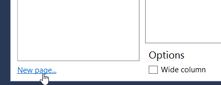

  8. At the bottom of the Function editor, click New page.
  9. Specify a name for the page and click OK.
  10. Add parameters that need to be displayed by the virtual function resource by dragging them from the Parameters column on the right to the Layout section in the middle.
    New Function option in Function Editor
  11. To save the virtual function, in the upper-right corner, click Apply Changes.
