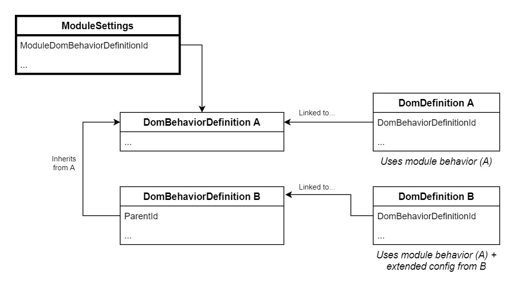

Inheritance
One DomBehaviorDefinition can inherit from another. However, there are important limitations in place:
It can only inherit from the
ModuleDomBehaviorDefinition(the ID is defined in the ModuleBehaviorDefinition property of theModuleSettings).The inheriting definition can only contain an ID, parent ID, and extra:
DomStatusSectionDefinitionLinksforSectionDefinitionsthat are not already defined on the module definition.ButtonDefinitions(with other IDs than those defined on the parent).ActionDefinitions(with other IDs than those defined on the parent).
Adding extra statuses or transitions on the child definition is not allowed.
This logic makes it possible to define a complete status system that should be used by all DomDefinitions. With an inheriting DomBehaviorDefinition, you can then define the visibility, requirements etc. for fields of extra SectionDefinitions.
