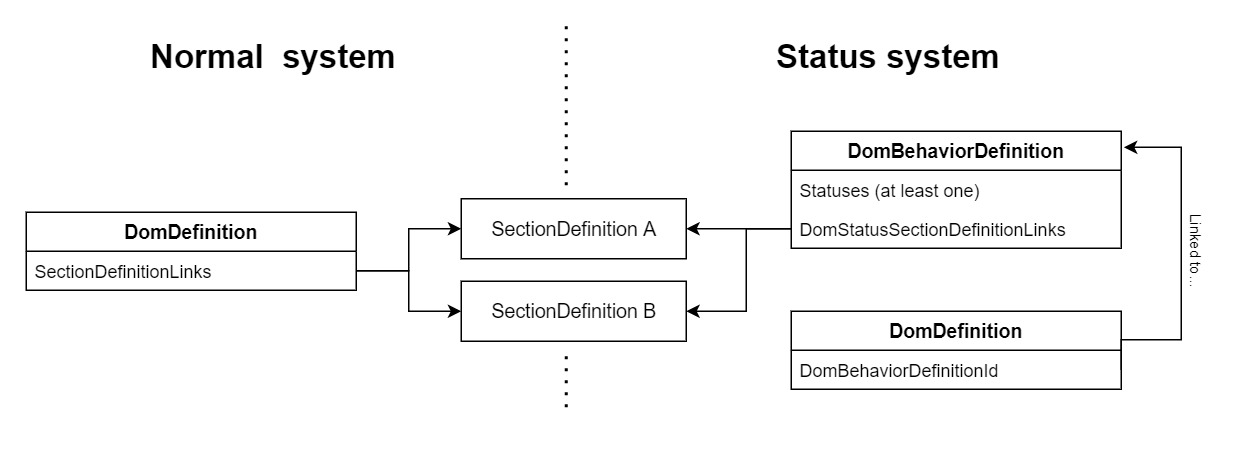

Using the status system is an alternative way of defining which data must be present in a DomInstance. That means that the SectionDefinitionLinks on the DomDefinition are not used in that case. Additionally, the following properties on the FieldDescriptor will be ignored:
  • IsOptional
  • IsHidden
  • IsReadonly
Status system overview
  • This feature is supported from DataMiner 10.1.11/10.2.0 onwards.
  • A DOM manager detects that the status system is used from the moment that a DomDefinition is linked to a DomBehaviorDefinition AND that DomBehaviorDefinition contains at least one status.

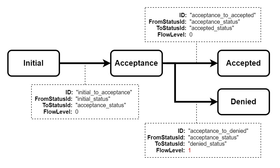

Configuring transitions
You can configure what transitions are allowed by adding a DomStatusTransition object to the Transitions list property on the DomBehaviorDefinition. A DomStatusTransition has the following properties:
Property Type Description
Id string The ID of this transition. It must contain lowercase characters only (e.g., "initial_to_accepted_status").
FromStatusId string The ID that the DomInstance will transition from.
ToStatusId string The ID that the DomInstance will transition to.
FlowLevel int The level of flow between transitions. The main transition will have the highest priority (0 is highest). An alternate transition from the same status will then have the value 1 or more.
Transitions overview
Make sure that the Transitions collection does not contain DomStatusTransition objects with the same ID.
