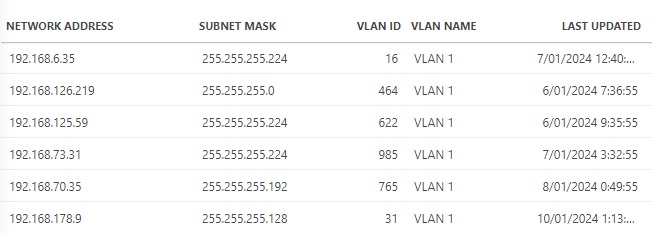

Step 3: Add a query and visualize it
  1. Create a GQI query using the "IP subnets - Dummy" ad hoc data source.
  2. Add a GQI operator of type "Filter":
    1. Select the "VLAN Name" as the column to filter on.
    2. Select the "contains" filter method.
    3. Fill in the "VLAN 1" as the value for the filter.
  3. Visualize the result in a Table component.
    The result should look like this:
    Statically filtered query

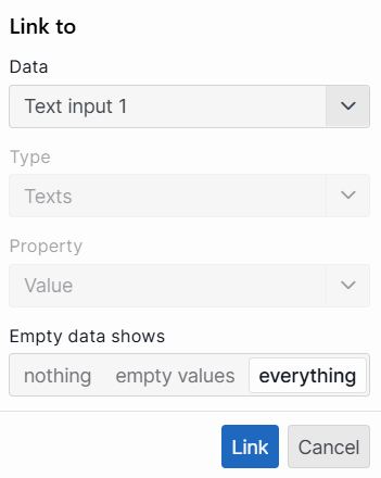

  1. Edit the GQI query again and open the filter operator.
  2. In the Value box, click the Link to icon. This icon is used everywhere a user can link a value to data.
    Clicking the icon opens the Link to dialog, which will ask for specific data, the type, and a property.
  3. Specify the necessary info in the dialog:
    1. In the first box, select "Text input 1".
      You will notice that the type and property are automatically filled in if only one possible value is available.
    2. To determine what the behavior should be when the data is empty, at the bottom of the dialog, select everything.
      This determines what will happen when the user does not fill in any value in the text input. Selecting everything ensures that all data is retrieved in this case.
      Link to pop-up window
      If you want the text input to behave like a search engine, you can select nothing instead. This will not retrieve any data until the user fills in a value in the text input.
  4. Select Link in the lower-right corner of the Link to dialog.
