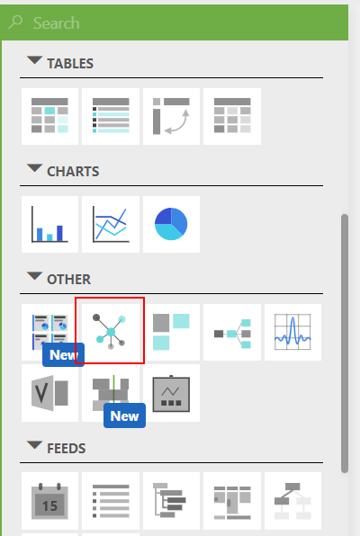

  4. Drag a Node edge graph visualization from the pane on the left onto the dashboard.

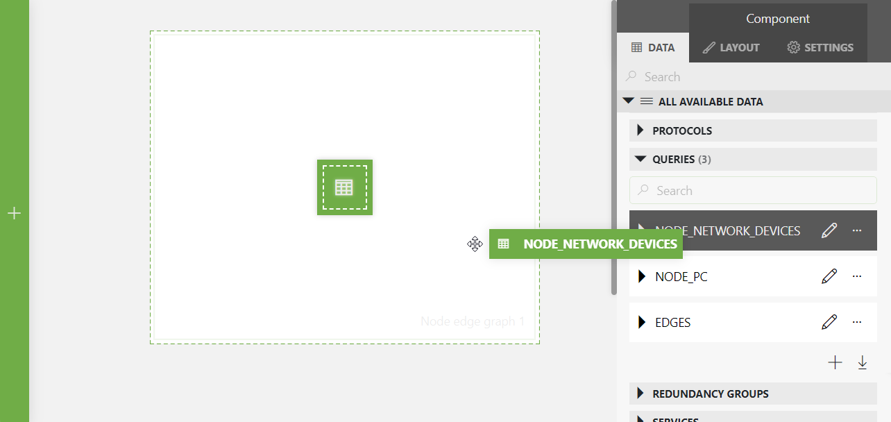

  5. In the Data pane on the right, expand the Queries node, and drag the following queries to the visualization you have just added:
    • Node_Network_Devices
    • Edges
    Add queries to the visualization

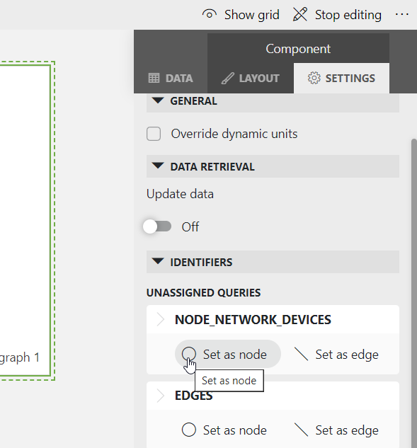

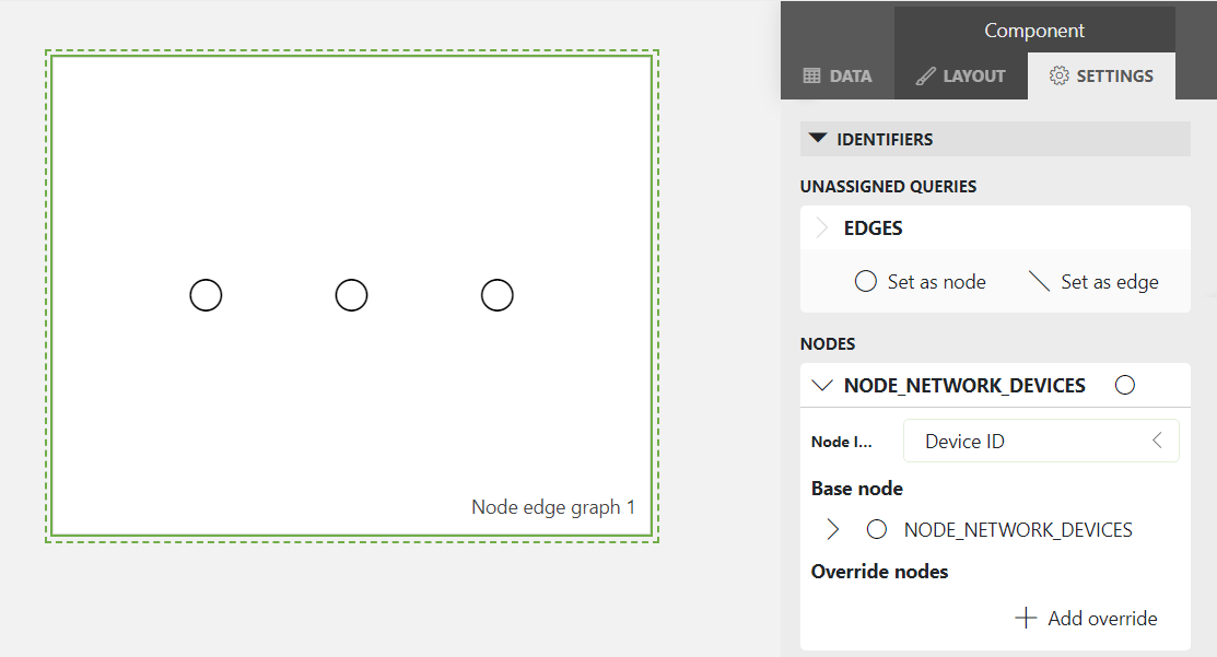

  1. Click the node edge graph component you have added to select it.
  2. Select the Settings pane on the right.
    The queries you added earlier will be listed under Unassigned queries.
  3. Under the query Node_Network_Devices, select Set as node.
    Set a query as node
    The selected query will be moved to the bottom of the pane.
  4. For the same query, set Node ID column to the column Device ID.
    This way, you indicate that the Device ID column contains the IDs representing the different entities that should be shown as nodes.
    Three nodes will now be displayed in the node edge graph component, representing a router and two switches. By default, the icon displayed for each node is a circle.
    Specify the node ID column

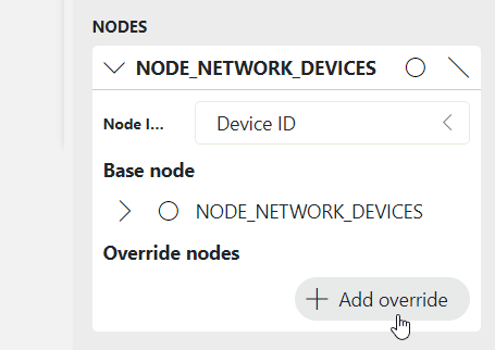

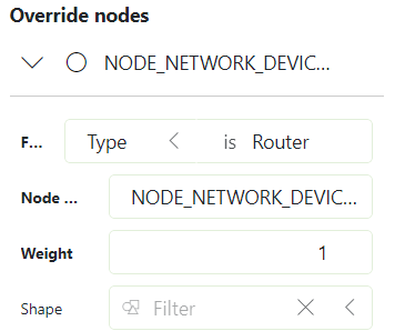

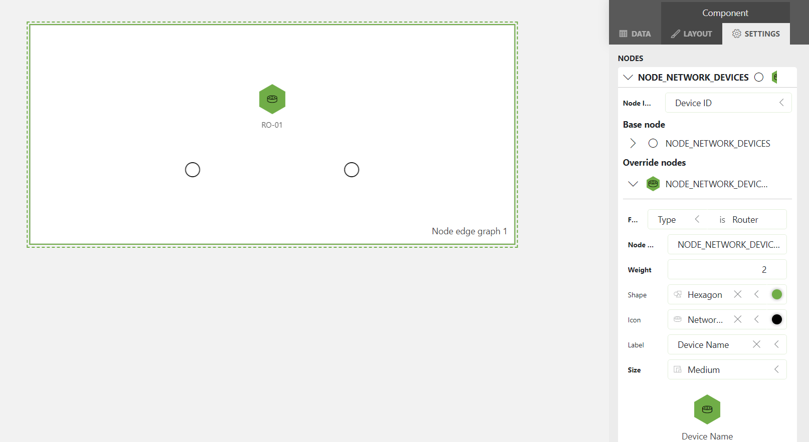

  5. Add an override for the router node:
    1. Click Add override.
      Add override
    2. In the Filter box, select Type.
      A text box will now be displayed to the right of the filter.
    3. In the text box, specify Router.
      Set filter type to Router
    4. In the Weight box, specify 2.
      This will ensure that the node representing the router is positioned at the top of the component. This is because with the default layout settings, the higher the weight of a node, the higher the position of the node in the graph.
    5. In the Shape box, select Hexagon.
      The node representing the router will now have a hexagon shape. Optionally, you can also change the color of the shape by clicking the colored circle to the right of the Shape box.
    6. In the Icon box, change select NetworkDeviceScanning.
      To quickly find a specific icon in the list, start typing the name of the icon in the box.
    7. In the Label box, select Device Name.
      The name of the device will now be displayed below the node representing the router.
      Router node override

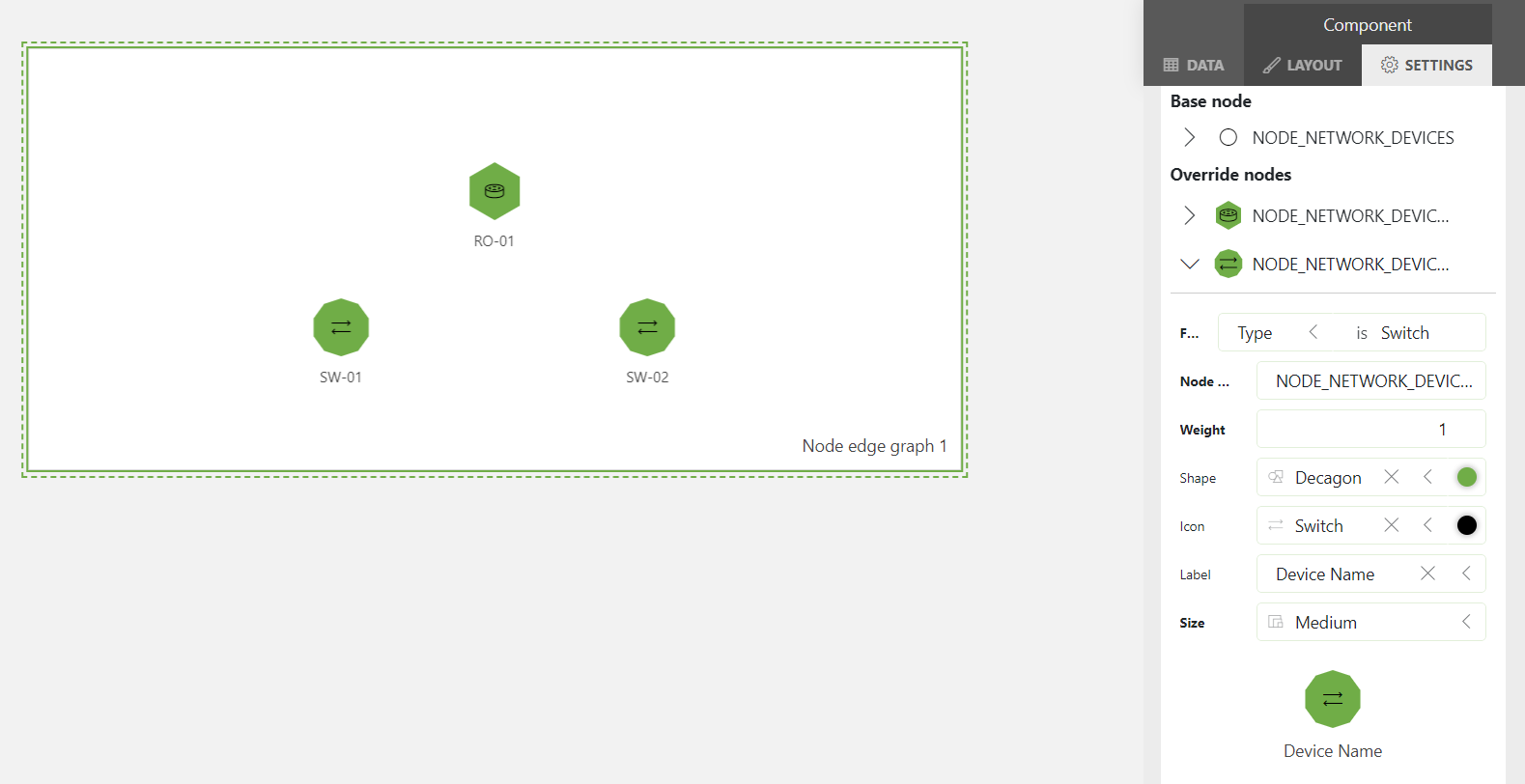

  6. Add an override for the switch nodes:
    1. Click Add Override again.
    2. In the Filter box, select Type, and enter the value Switch in the box on the right.
    3. Keep the Weight set to 1.
      This will ensure that the nodes representing the switches are positioned below the router node.
    4. In the Shape box, select Decagon.
      The node representing the switch will now have a decagon shape. Optionally, you can also change the color of the shape by clicking the colored circle to the right of the Shape box.
    5. In the Icon box, select Switch.
    6. In the Label box, select Device Name.
      The nodes should now look like this:
      Switch nodes override

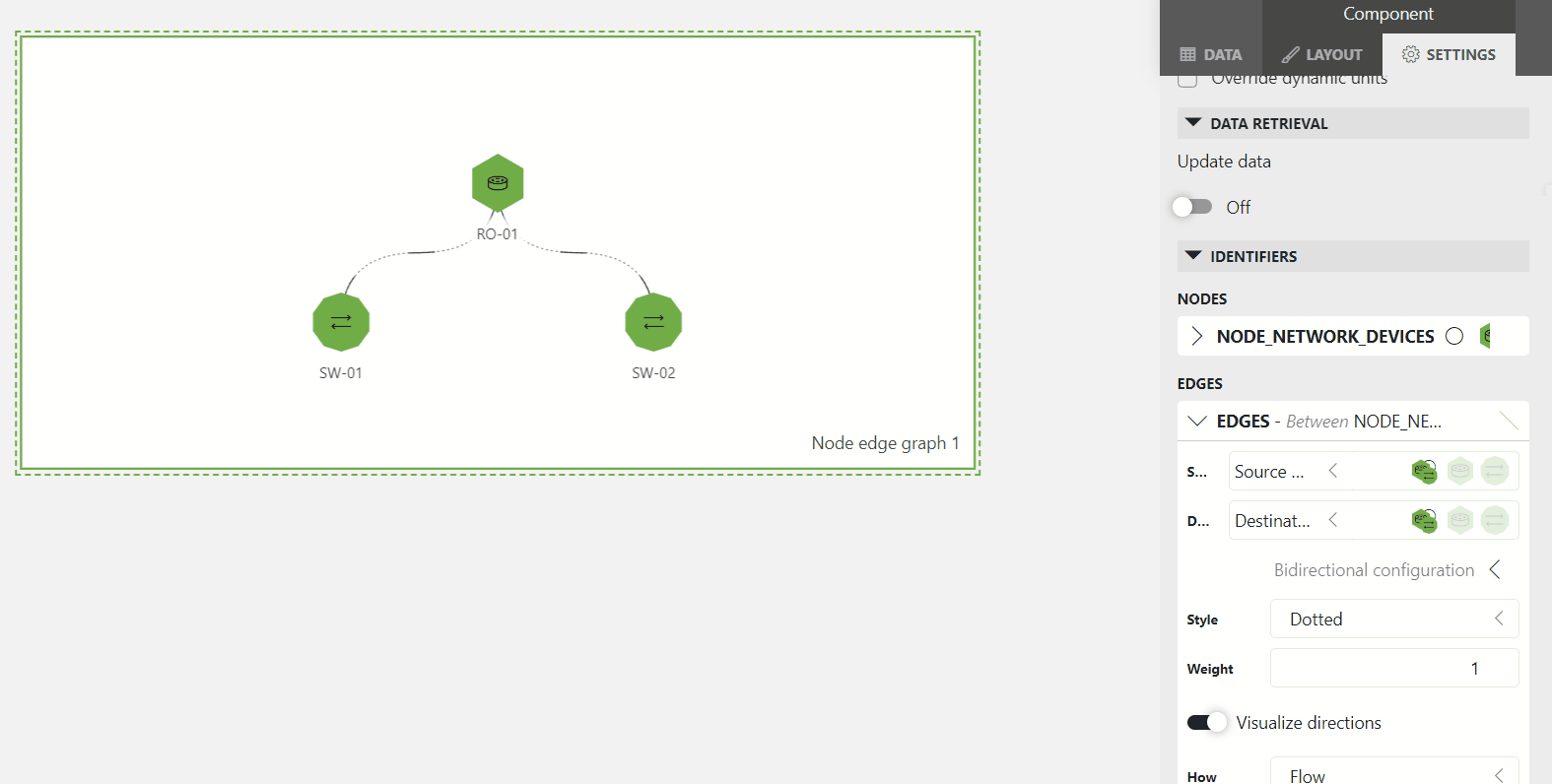

Step 4: Configure the edges between router and switch nodes

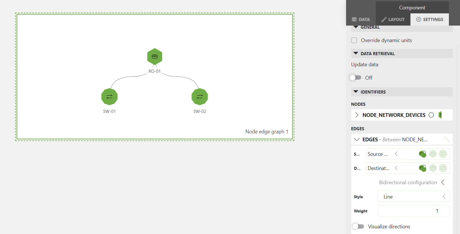

  1. At the top of the Unassigned queries list, under the query Edges, select Set as edge.
    The query will be moved to the bottom of the pane.
  2. In the Source box, select Source Device ID.
  3. In the Destination box, select Destination Device ID.
    The edges connecting the router and switches will now be displayed in the node-edge graph visualization.
    Edges between router and switch nodes
  4. In the Style box, select Dotted.
  5. Enable the toggle button Visualize Directions.
    An animation showing the direction of the connection between the switches and the router will now be displayed. The direction will be from switch to router.
    Edges visualizing the directions

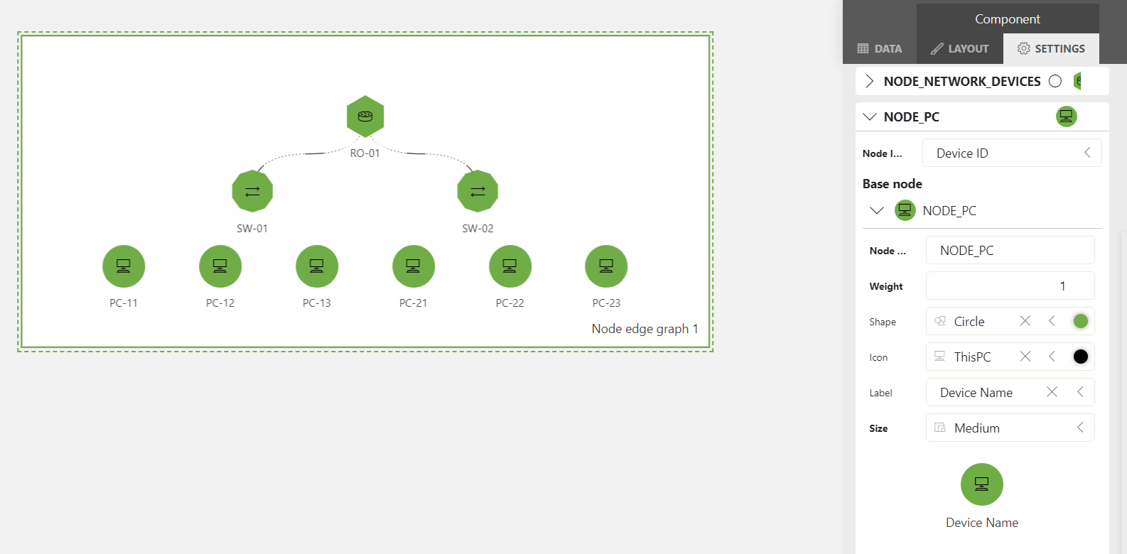

Step 5: Add nodes representing PCs
In this step, you will add extra nodes representing PCs to the component. The same Edges query will be used for this, as this query contains the connections between all devices.

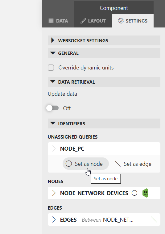

  1. From the Data pane on the right, drag the Node_PC query to the node edge graph component.
  2. Click the node edge graph component to select it, and select the Settings pane on the right.
  3. Under Unassigned queries, set the Node_PC query as node.
    Set the query as node
    The selected query will be moved below the node query you configured earlier.
    Six nodes will be displayed in the node edge graph component. By default, the icon displayed for each node is a circle.
  5. Expand the Node_PC base node by clicking the triangle icon next to it.
    This will display the list of settings for this node. Instead of overriding this node, you will now update the settings for the base node. This means that all the nodes for this GQI query will be updated in the same way.
  6. In the Shape box, select Circle.
    The node representing the PCs will now have this shape. Optionally, you can also change the color of the shape by clicking the colored circle to the right of the Shape box.
  7. In the Icon box, select ThisPC.
  8. In the Label box, select Device Name.
The resulting nodes will look like this:
PC nodes

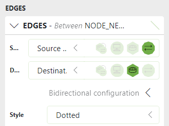

  1. Override the edges between router and switches:

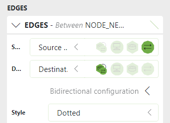

    1. Extend the GQI Query Edges configured Step 2.
      The fields Source and Destination will be displayed. Next to these fields, you will see different icons. These represent the nodes configured in the previous steps.
    2. For the Source field, click the icon that is highlighted by default.
      This way, the icon will no longer be selected.
    3. Click the icon representing the switches instead.
      Switch icon as source
    4. For the Destination field, also click the currently highlighted icon to deselect it, and then click the icon representing the router.
      Router icon as destination
      The connections between switches and routers will now be displayed.

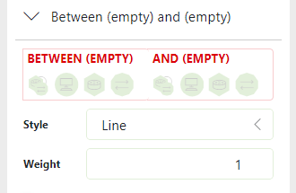

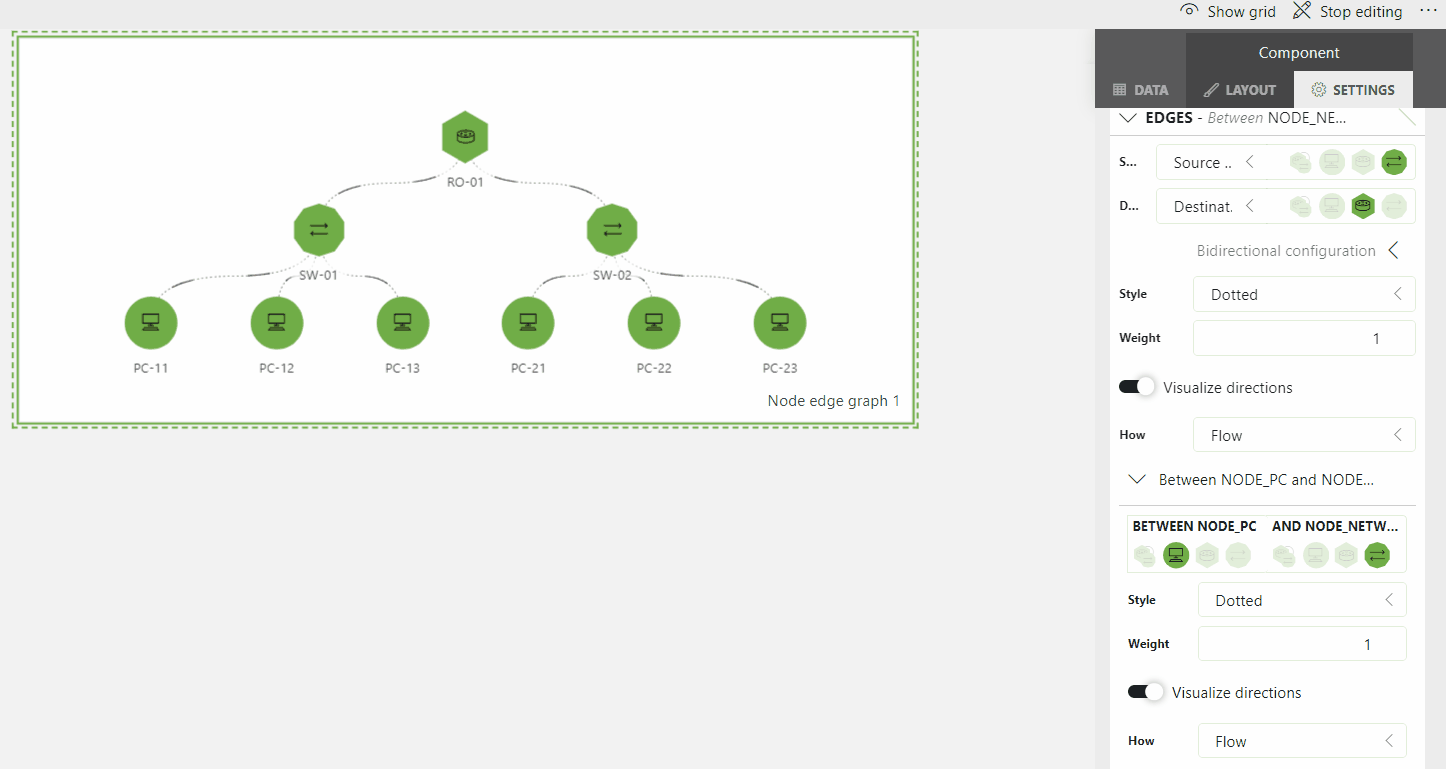

  2. Override the edges between PCs and switches:
    1. At the bottom of the Settings pane, click Add Override.
      The following setting will be displayed:
      Edges override
    2. Under Between (empty), select the icon representing the PCs
    3. Under And (empty), select the icon representing the switches
    An animation showing the direction of the connection between the PCs and the switches will now be displayed. The direction will be from PC to switch. With this, your node edge graph is now complete.
