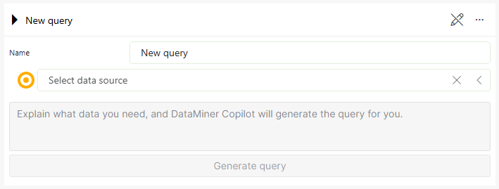

Letting DataMiner Assistant create a query
From DataMiner 10.4.0 [CU13]/10.5.0 [CU1]/10.5.4 onwards, you can use the DataMiner Assistant natural language to GQI feature to automatically create a GQI query based on a request in natural language.
To do so, in a system where DataMiner Assistant has been deployed, when you click the "+" button to add a query, type your request in the textbox and click Generate query. DataMiner Assistant will then create the desired GQI query and generate a relevant query name.
NL2GQI
Natural language to GQI feature in DataMiner 10.6.1
For more information about how to deploy this feature, see DataMiner Assistant DxM.
DataMiner Assistant can make mistakes. We recommend manually checking the resulting queries and correcting or extending them to your liking when necessary. However, keep in mind that typing a new request and clicking the button a second time will override the query, causing all manual changes to be lost.

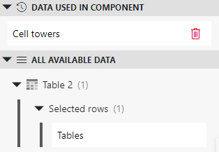

  • From DataMiner 10.2.0/10.1.4 onwards, if a row is selected in a table component that uses a query data source, any view, service, or element linked to that row is also exposed as a data source. In practice, this means that a data source will be available in the Components or Feeds section of the Data pane (depending on your DataMiner version) that will change based on the selection in the table.
    Selected rows
    Data pane in DataMiner 10.4.12
