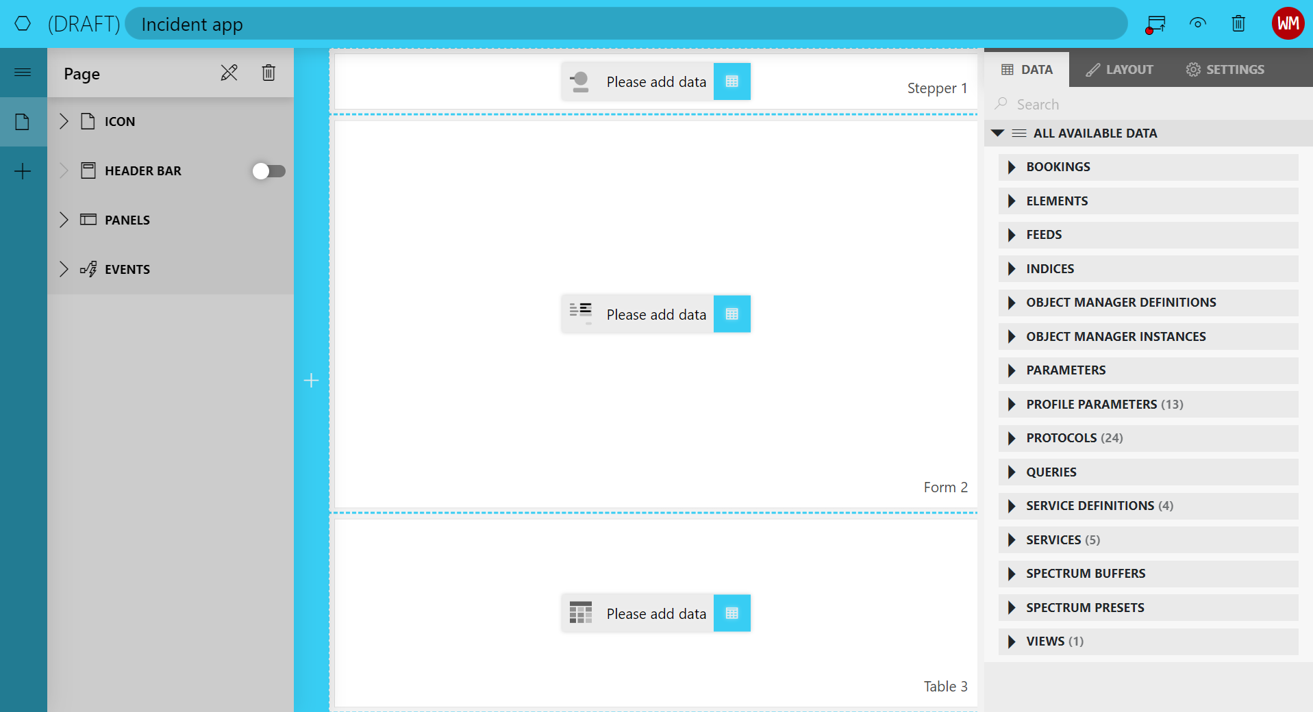

  3. Hover the mouse pointer over the bar with the "+" on the left until it expands to show the Visualizations pane, and add a stepper, a form, and a table component by dragging them onto the page.
    You can find the stepper and form components in the General category and the table in the Tables category.
The end result of this step should look like this:

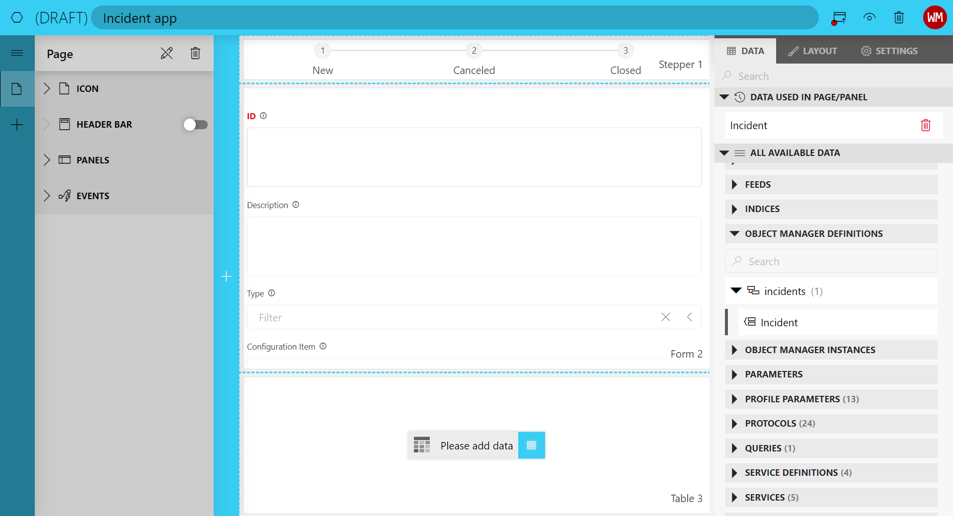

  • Add the DOM definition to the stepper component and the form component.
    Definition data

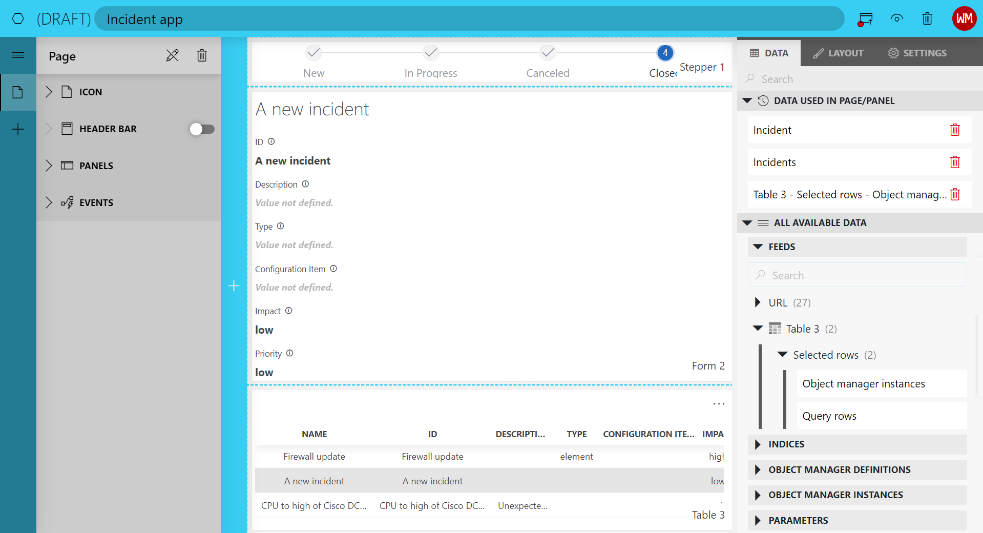

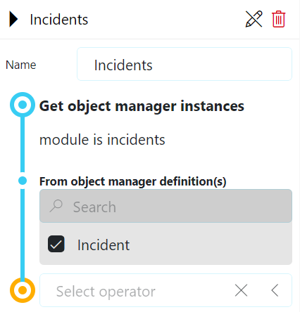

  • Create a query to fetch all object manager instances of the DOM definition and add it to the table component. See Creating a GQI query.
    Incidents query
  • Link the Object manager instances data from the table component to both the stepper and the form component. Make sure to select a row in the table to expose this data.

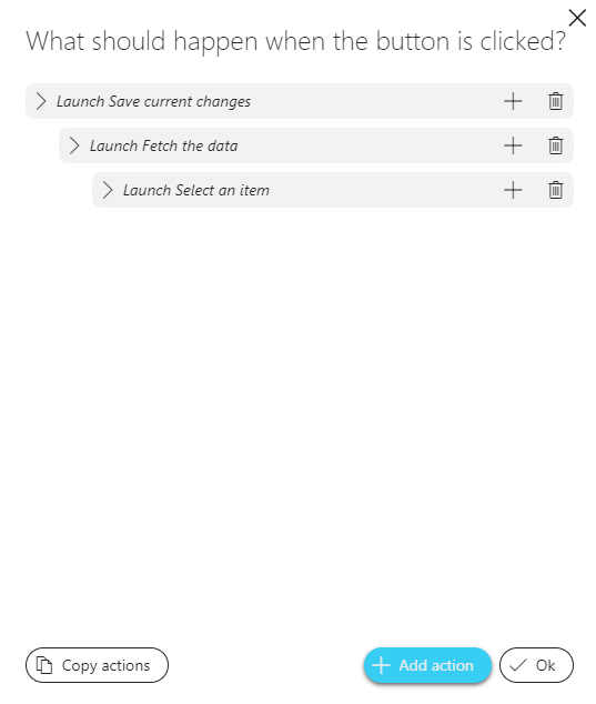

To complete the app, you should now add a header bar with a button to save changes to incidents:
  1. Enable the header bar and add a button to it. See Configuring the app header bar.
  2. Add a chain of the following three actions to the On click event of the button:
    1. Save the current changes of the form component.
    2. Fetch the data in the table component.
    3. Select the updated incident in the table component.

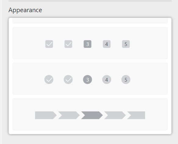

By default, every stepper component uses the same template, but you can switch to a different template of your choice.
To do so, use the Appearance setting in the component Layout pane on the right.

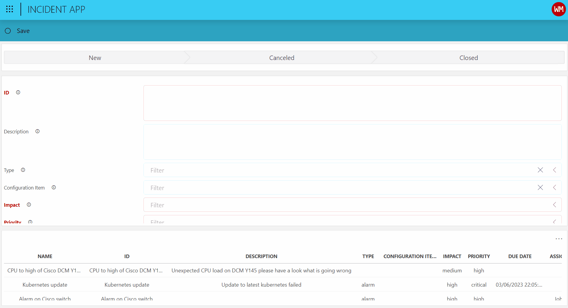

Now that everything is configured, you can publish and use your app.
You can create new incidents using the form component and the save button in the header bar. You can inspect and update existing incidents by selecting them in the table component at the bottom.
The stepper component will visualize the past states and the possible future states of an incident. This visualization will clearly show what steps were taken to resolve the incident and what steps still need to happen before it is fully resolved.
