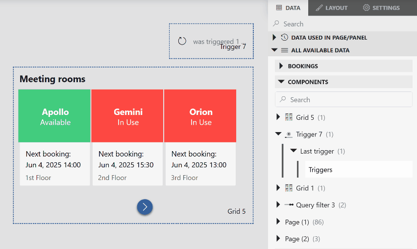

To use a trigger component to refresh the data in another component:
  1. Add a trigger component to your dashboard or app.
  2. From DataMiner 10.5.0 [CU12]/10.6.3 onwards, navigate to All available data > Components > [Page/Panel name] > Trigger > Last trigger > Triggers in the Data pane, and drag this component data onto a compatible component (e.g., a table or grid component).
    Note that in older DataMiner versions, the exact path may be different. For example, in versions prior to DataMiner [CU21]/10.3.0 [CU9]/10.4.12, component data is found under the Feeds data category.
    Link component to trigger
    Grid component and trigger component in DataMiner 10.5.8
  3. Optionally, enable a trigger timer to automatically refresh the data in the linked component at regular intervals.
  4. In read mode, either click the trigger button (default: Trigger button) to manually update the data, or wait for it to refresh automatically based on the configured timer.

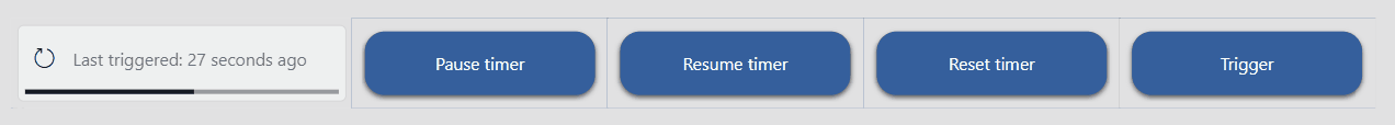

Letting users control the trigger timer
From DataMiner 10.4.0 [CU17]/10.5.0 [CU5]/10.5.8 onwards, you can make the timer interactive by allowing users to manually pause, resume, reset it, or trigger an update immediately. This can be useful, for example, if users want to temporarily stop automatic updates while analyzing data.
Control the timer
Trigger component and button components in DataMiner 10.5.8
You can do this by configuring component actions in your low-code app using events. These actions can be linked to button components or other UI elements, giving users more control over how and when data is refreshed.
To configure this:
  1. Add an event to your app. See Configuring app events.
  2. From the dropdown list, select Execute component action.
  3. Under I want to, choose one of the available options under Trigger:
    • Continue timer: Resumes the timer if it is currently paused.
    • Pause timer: Pauses the timer. If Show when the last trigger happened is enabled, the displayed time continues updating based on the last trigger.
    • Reset timer: Resets the timer. The paused or running state of the timer is not affected. If Show when the last trigger happened is enabled, the displayed time is not reset.
    • Trigger: Immediately activates the trigger, without resetting or affecting the timer.
