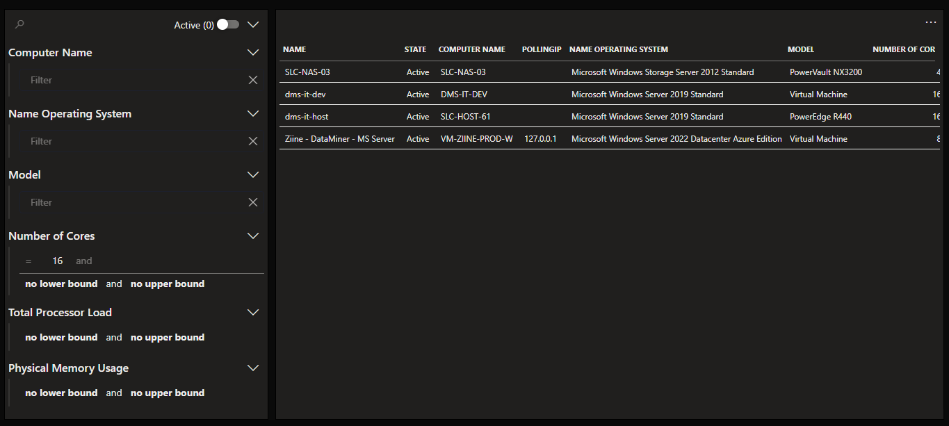

Query filter component in DataMiner 10.4.5

  1. Add a table component to your dashboard.
    In this example, we are using a table component. However, any component capable of receiving a query can be linked to the query filter.
  2. Go to All available data > Components > [Page/Panel name] > Query filter > Filters > Queries in the Data pane and drag it onto the table component.
    Note that depending on your setup, the exact path may be different. For example, in versions prior to DataMiner [CU21]/10.3.0 [CU9]/10.4.12, component data is found under the Feeds data category.
    Each time you change the query filter, a new query is passed to the table, displaying only rows that match the filter settings.
  2. In the Data pane, go to All available data > Queries. Drag the query you created earlier onto the table component.
  3. Go to All available data > Components > [Page/Panel name] > Query filter > Filters in the Data pane and drag Query columns onto the yellow filter drop area of the table component.
    Each time you change the query filter, the data inside the table is filtered according to the filter settings in the query filter. No new query is passed to the table. The latter keeps displaying all rows, but those that do not match the filter will turn gray.
