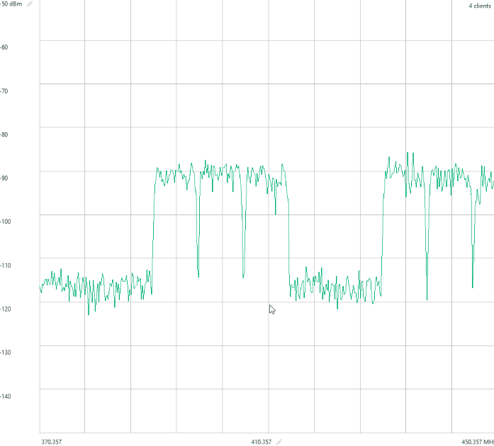

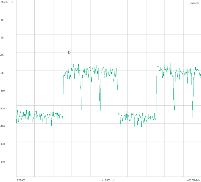

Panning the trace is supported from DataMiner 10.3.11/10.4.0 onwards:
  • To pan horizontally, click the trace and drag your mouse.
    Pan horizontally
    Spectrum analyzer trace in DataMiner 10.4.1
    The following will happen:
    • The trace moves to the left or right while being refreshed at a rate equal to the original rate.
    • The unknown part of the trace (i.e., the frequency range located outside of the original span) is visualized as a gray area with a grid in the background.
    • The frequency labels on the X axis are updated continuously to reflect the ongoing change.
    When you release the mouse button, the info pane to the right of the display section will automatically update with start, stop, and center frequencies that align with the new data. A new trace based on the updated center frequency will replace the gray area.
