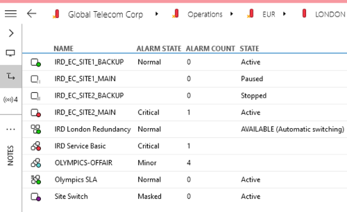

BELOW THIS VIEW
Under the BELOW THIS VIEW node, there is a page for each type of item that can be contained within the view. Next to the item name, a number is displayed that indicates how many of these items are in the view. Click a page in the tree view to display a list of the items in question.
BELOW THIS VIEW page in DataMiner 10.6.5
The data pages can be displayed in several ways. You can change the way they are displayed by means of the buttons in the lower-right corner of the page.

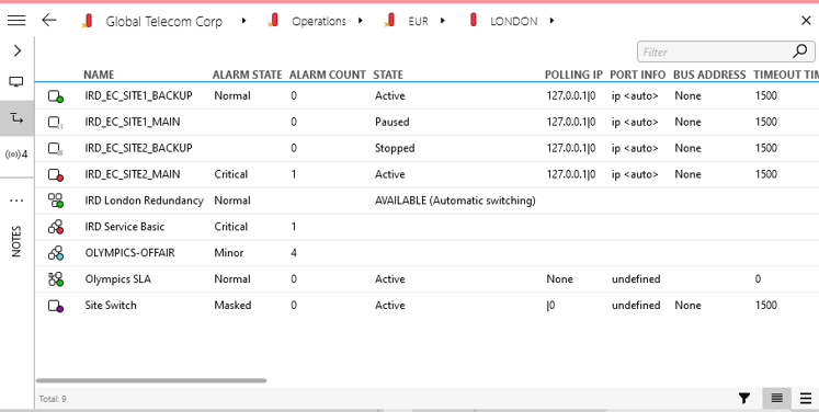

List view
In the list view, a detailed list of the items in the view is displayed, with information such as the name, alarm state, alarm count, protocol, alarm and trend template, ID, etc. The information is automatically updated when objects in the view are added, updated or deleted.
List view in DataMiner 10.6.5
The list can be manipulated to display data according to your preference:
Click a column header to sort the list.
Click the same column header again to reverse the sort order.
Click and drag a column header to change the order of the columns.
Use the filter box in the upper-right corner to filter the displayed items.
See also: Using quick filters
The list consists of the following columns:
Name: The name of the item.
Alarm state: The current alarm state of the item.
Alarm count: The current number of alarms on the item.
State: The current status of the item. For an element or SLA, this can be active, paused or stopped. For an overview of the possible states of a redundancy group, see Checking the current state of a redundancy group.
Polling IP: Relevant for elements only. The IP address used to communicate with the data source, if any.
Port info: Relevant for elements only. The port used to communicate with the data source, if any.
Bus address: Relevant for elements only. The bus address of the data source, if any.
Timeout time: Relevant for elements only. The timeout time for a single request for each of the element’s connections (in milliseconds). For multiple connections, the values are separated by commas.
Element timeout time: Relevant for elements only. The total timeout time for each of the element’s connections (in milliseconds). This is the timeout time that corresponds with the element setting The element goes into timeout state when [...] (see Adding elements). For multiple connections, the values are separated by commas.
Slow poll: Relevant for elements only. The number of milliseconds that each of the element connections has to be in timeout before they are placed in slow poll mode. For multiple connections, the values are separated by commas. For more information on slow poll mode, see Adding elements.
# of retries: Relevant for elements only. The total number of times DataMiner will send the same command again in case it does not receive a response. For multiple connections, the values are separated by commas.
Protocol and Protocol version: Relevant for elements and SLAs only. The name and version of the protocol used for communication between the DMA and the data source.
Alarm template: Relevant for elements and SLAs only. The name of the alarm template used for alarm monitoring of the element or SLA.
Trend template: Relevant for elements and SLAs only. The name of the trend template used for trending of the element or SLA.
Protocol type: Relevant for elements and SLAs only. Type of the protocol, e.g., serial, snmp, virtual, sla, etc.
Communication protocols: Relevant for elements only. The communication protocols used by the element, e.g., Serial. Displayed from DataMiner 10.2.0/10.2.1 onwards.
ID: The unique ID of the item, which consists of the ID of the DMA where the item was created and the ID of the item itself, separated by a forward slash.
Host ID: The ID of the DMA hosting the item.
DataMiner: The name of the DMA hosting the item.
Type: Relevant for elements and SLAs only. Type of item as defined in the protocol, e.g., Matrix, IRD, Service Level Agreement, etc.
Display type: Relevant for elements only. The display type as defined in the protocol, i.e., spectrum analyzer for spectrum analyzer elements or element manager for EPM elements.
IP: The virtual IP of the element in DataMiner, if any.
Description: The user-defined description of the element, if any.
Impacted services: The services the item is included in, if any.
SLA service: Relevant for SLAs only. Indicates the service monitored by the SLA.
Isolation mode: Available from DataMiner 10.5.6/10.6.0 onwards. Relevant for elements only. Indicates whether the element is running in isolation mode. Possible values include:
None: Not applicable. For example, when viewing the All page of a service.
Disabled: The element is not running in isolation mode.
Enabled (protocol): Isolation mode is enabled via the protocol.xml file and applies to all elements using this protocol version.
Enabled (element): Isolation mode is enabled via the element’s own settings.
Enabled (DMA): Isolation mode is enabled via a DMA-wide setting that applies to all elements using the protocol.
By default, this column is hidden. To display it, right-click a column header and select Add/Remove setting column > Isolation mode.
Additional columns with user-defined properties can be added or removed via the column header context menu.

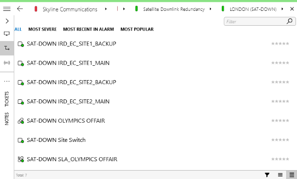

Summary view
In the summary view, you can choose to view one of four different lists showing limited information about the items in the view. The lists are automatically updated when items in the view are added, updated or deleted.
Summary view in DataMiner 10.6.5
| List | Description |
| All | All items in the view. |
| Most severe | Only the items with the most severe alarm states. |
| Most recent in alarm | Only the items that have recently been put in an alarm state. |
| Most popular | The items that are frequently being viewed. |
