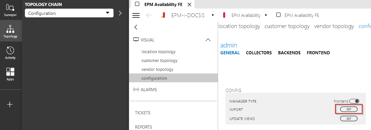

Open the Configuration topology chain in the Topology app.
In the frontend visual overview, click the Set button next to Import to begin the provisioning.
If you cannot see the Topology app in between the Surveyor and Activity modules in Cube, close and reopen DataMiner Cube. If this has no effect, and you are using a DataMiner Cube version prior to DataMiner Cube 10.4.0 [CU14]/10.5.0 [CU2]/10.5.5, make sure the CPEIntegration soft-launch option is enabled. If you are using a recent DataMiner version or the option is enabled, and the app is still not shown, restart DataMiner.
