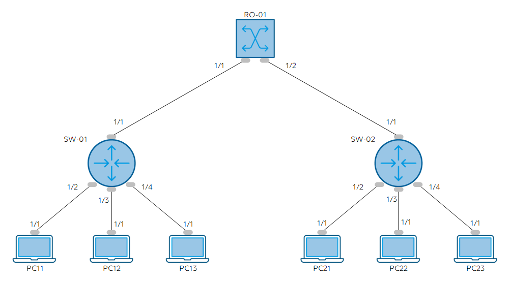

The objective of this tutorial is to build the following network connectivity diagram in a visual overview and a node edge graph using DCF:
Kata DCF Network Diagram
Where:
  • RO-x: Router
  • SW-x: Switch
  • 1/x: Represents the port number from the device
For example, from the diagram you can infer the following:
  • RO-01 connects to SW-01 using the interface Port Ethernet 1/1.
  • SW-01 connects to RO-01 using the interface Port Ethernet 1/1.
  • SW-01 connects to PC-11 using the interface Port Ethernet 1/2.
  • PC-11 connects to SW-01 using the interface Port Ethernet 1/1.

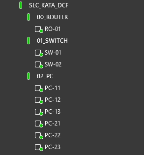

  3. When the package has been fully deployed, in the Automation module in DataMiner Cube, go to the folder Kata DCF and execute the script SLC-AS-Kata-DCF to provision the components required for this tutorial.
    When the script is complete, the following items should become available in the Surveyor:
    • Views:
      • SLC_KATA_DCF
      • 00_ROUTER
      • 01_SWITCH
      • 02_PC
    • Elements:
      • RO-01
      • SW-01
      • SW-02
      • PC-11
      • PC-12
      • PC-13
      • PC-21
      • PC-22
      • PC-23
    Kata DCF Provisioned Elements

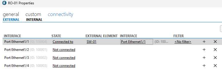

  1. Define connections between the router and switches:
    1. In the 00_ROUTER view, right-click the element RO-01, and select Properties.
    2. In the Properties window, go to the connectivity > external tab.
    3. In the State column, select Connected to for the interface Port Ethernet 1/1.
    4. In the External column, select the element SW-01.
    5. In the Interface column on the right, select the interface Port Ethernet 1/1.
      DCF Connection Visual Overview
    6. Click the Apply button in the lower-right corner.

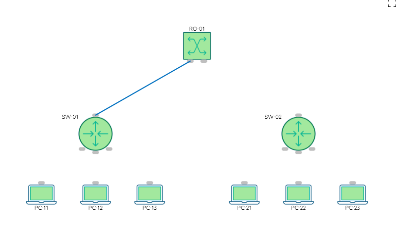

      This will apply your changes and create the connection. The VISUAL page of the SLC_KATA_DCF view will display the DCF connection.

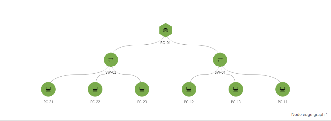

Step 3: Create a node edge graph using DCF connections
  1. Go to the Dashboards app.
  2. In the pane on the left, in the KATA_DCF folder, select the KATA_DCF dashboard.
  3. Click the pencil icon in the dashboard header bar to start editing the dashboard.

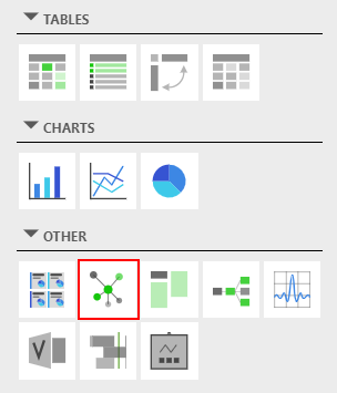

  4. Drag a Node edge graph visualization from the pane on the left onto the dashboard.
  5. Drag the edges of the node edge graph component to resize it so that it will be large enough to easily show all nodes in the diagram.

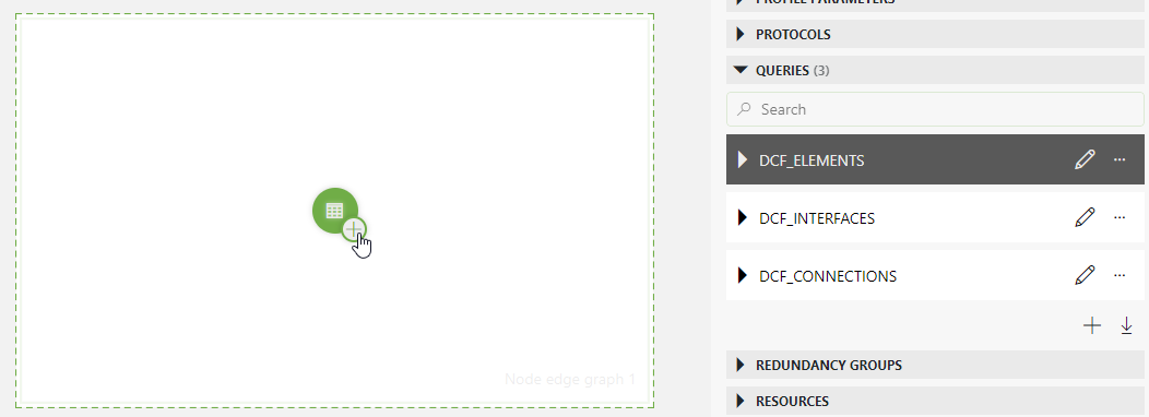

  6. In the Data pane on the right, expand the Queries node, and drag the following queries to the node edge graph component:
    • DCF_ELEMENTS: This GQI query contains the nodes
    • DCF_CONNECTIONS: This GQI query contain the connections between the nodes
    Add queries to the visualization
    Although the GQI query DCF_INTERFACES is not used directly in the node edge graph, it is used by the GQI query DCF_CONNECTIONS. The GQI query DCF_INTERFACES contains the link between the DCF interfaces and the parameters from the element.

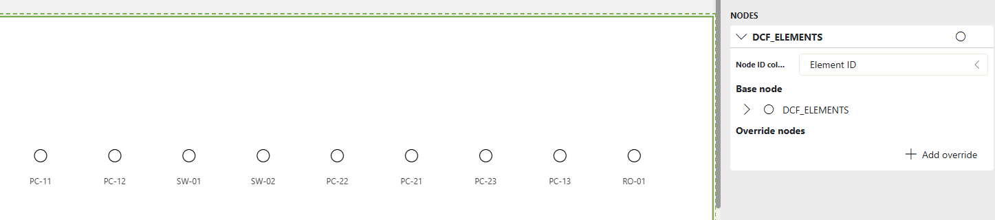

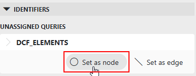

Step 4: Configure the nodes
  1. Select the node edge graph component you have added.
  2. Select the Settings pane on the right.
    The queries you added earlier will be listed under Unassigned queries.
  3. Under the query DCF_ELEMENTS, select Set as node.
    Select GQI query as node
    The selected query will be moved to the bottom of the pane.
  4. For the same query, make sure Node ID column is set to the column Element ID.
    This indicates that the Element ID column contains the ID representing the different entities that should be shown as nodes.
    Nine nodes should now be displayed in the node edge graph component, representing the router, switches, and PCs. By default, the icon displayed for each node is a circle.
    Nodes available in the GQI query

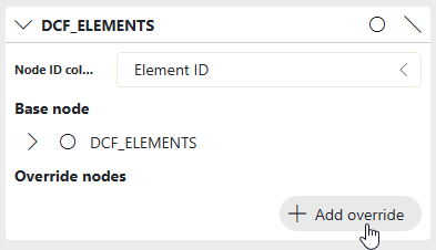

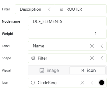

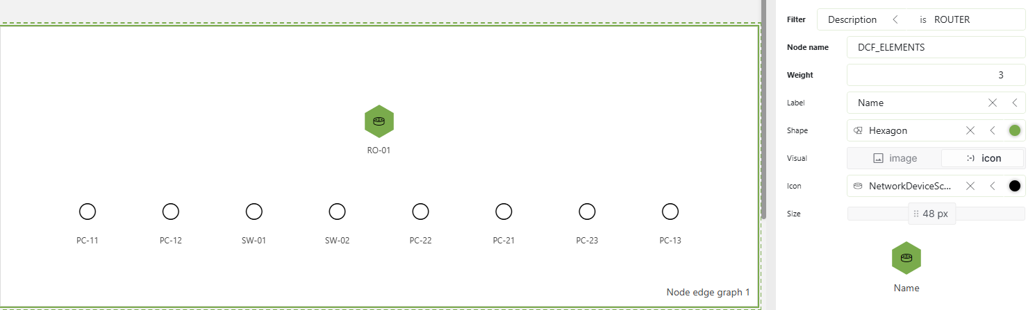

  5. Add an override for the router node:
    1. Click Add override.
      Add override to node
    2. In the Filter box, select Description. A text box will now be displayed to right of the filter.
    3. In the text box, specify ROUTER.
      Select node as router
    4. In the Weight box, specify 3.
      This will ensure that the node representing the router is positioned at the top of the component. This is because with the default layout settings, the higher the weight of a node, the higher the position of the node in the graph.
    5. In the Shape box, select Hexagon.
      The node representing the router will now have a hexagon shape. Optionally you can also change the color of the shape by clicking the colored circle to the right of the Shape box
    6. In the Icon box, select the icon NetworkDeviceScanning.
      To quickly find a specific icon in the list, start typing the name of the icon in the box.
    7. In the Label box, make sure Name is selected.
      The name of the device should now be displayed below the nodes.
      Router node fully configured

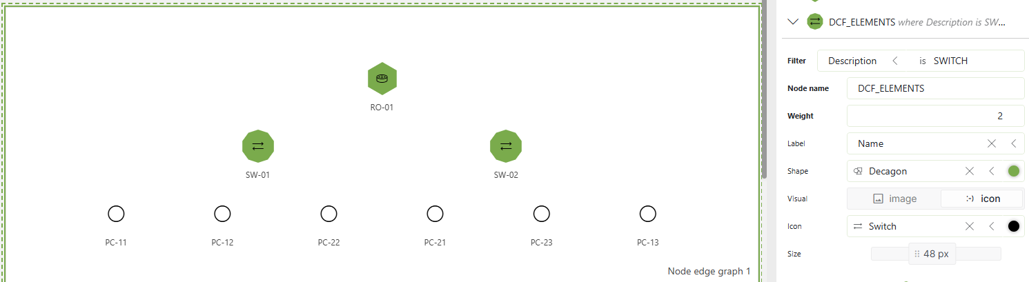

  6. Add an override for the switch nodes:
    1. Click Add Override again.
    2. In the Filter box, select Description, and enter the value SWITCH in the box on the right.
    3. Set the Weight to 2.
      This will ensure that the nodes representing the switches are positioned below the router node.
    4. In the Shape box, select Decagon.
      The node representing the switch will now have a decagon shape. Optionally, you can also change the color of the shape by clicking the colored circle to the right of the Shape box.
    5. In the Icon box, select Switch.
    6. In the Label box, make sure Name is selected.
    The nodes should now look like this:
    Switch node fully configured

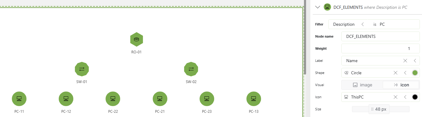

  7. Add an override for the PC nodes:
    2. In the Filter box, select Description, and enter the value PC in the box on the right.
    3. Keep the Weight set to 1.
      This will ensure that the nodes representing the switches are positioned below the switch node.
    4. In the Shape box, select Circle.
      The node representing the switch will now have a circle shape. Optionally, you can also change the color of the shape by clicking the colored circle to the right of the Shape box.
    5. In the Icon box, select ThisPC.
Step 5: Configure the edges
  1. At the top of the Unassigned queries list, under the query DCF_CONNECTIONS, select Set as edge.
    The query will be moved to the bottom of the pane.
  2. In the Source box, make sure Source element ID is selected.
  3. In the Destination box, make sure Destination element ID is selected.
The edges connecting the router and switches will now be displayed in the node-edge graph visualization.
Edges between router and switch nodes

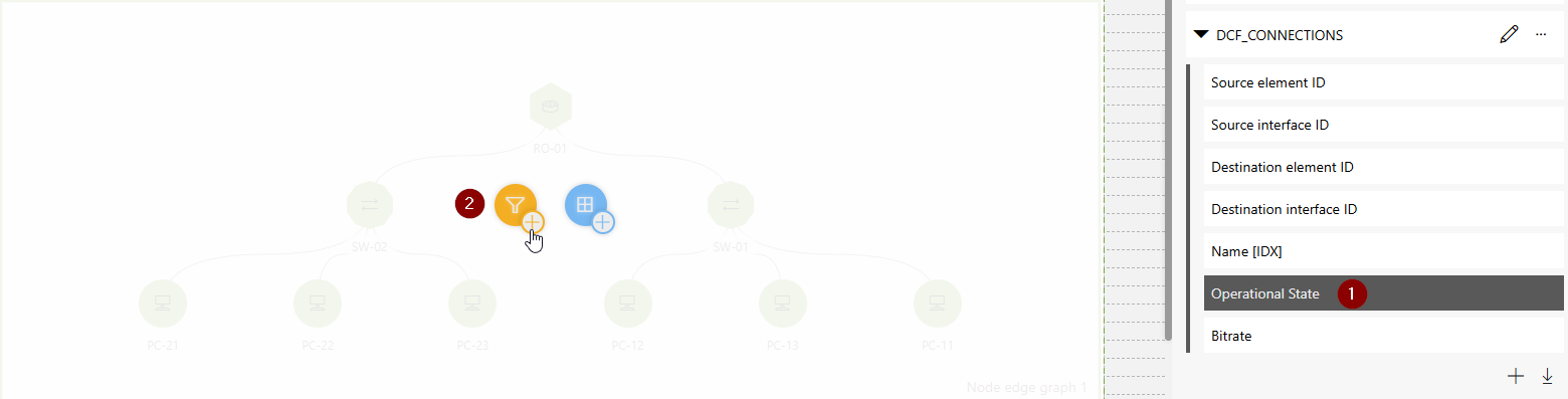

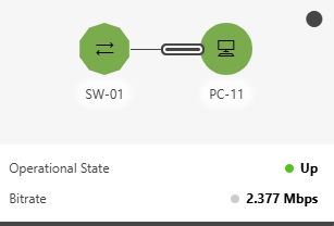

By default, when you click a connection in the graph, all the information related to the connection is displayed:
Default Connection Details
In this step, you will limit the displayed information so that only the parameters Operational State and Bitrate will be shown in the connection details.
  1. In the data pane, expand Queries > DCF_CONNECTIONS.
    The different columns of the DCF_CONNECTIONS query will be shown.
  2. Drag and drop the columns Bit Rate and Operational State to the node edge graph component as filters.
    Filtering columns from the query
  3. Click the pencil icon in the dashboard header again to stop editing the dashboard.
  4. Select a connection on the dashboard.
    Only the following properties should now be shown:
    Filtered Connection Details
