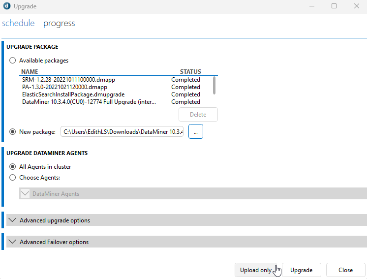

To upload an upgrade package:
  1. Open DataMiner Cube.
  2. Follow the upgrade procedure described in Upgrading a DataMiner Agent in System Center.
  3. During the final step of the upgrade procedure, instead of clicking Upgrade, select Upload only.
    Upload only
  4. If the upload was successful, you should receive the following upload report:
    Upload report
    Upload has been completed successfully.
When you upload a package, several prerequisite checks will be executed, so that you will immediately get informed if certain conditions or requirements for the update are not met yet.
