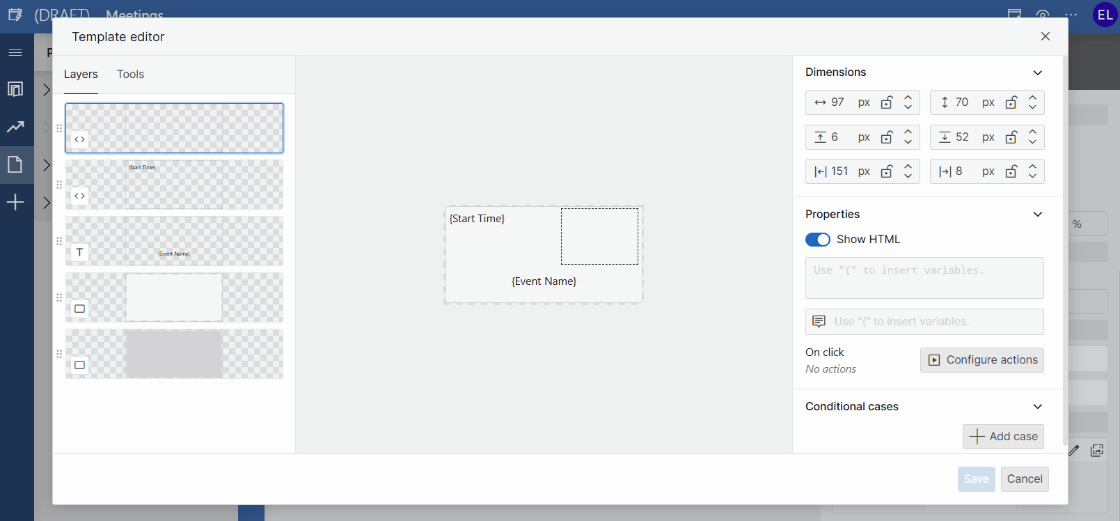

Template Editor UI overview
Template Editor
The Template Editor in DataMiner 10.4.1

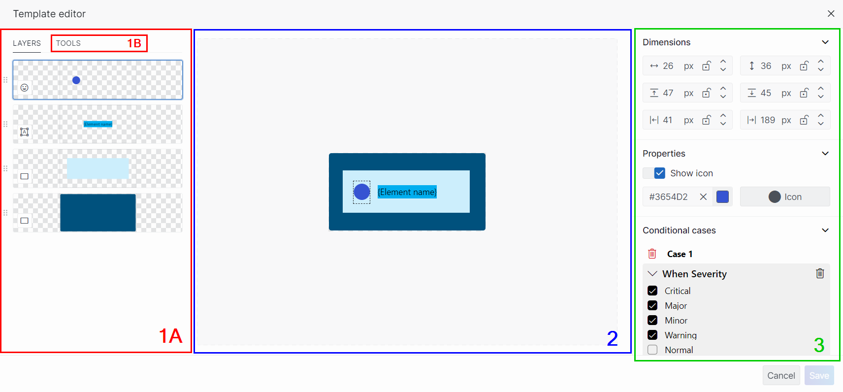

The Template Editor UI consists of the following main components:
  • Side pane:
    • The Layers tab (1A)
    • The Tools tab (1B)
  • Preview (2)
  • Settings pane (3)
Any changes made in the Template Editor are only saved once you click the Save button in the lower-right corner. When you close the Template Editor by clicking the "X" in the upper-right corner or the Cancel button in the lower-right corner, you will be alerted of any unsaved changes that may be lost if you close the editor prematurely.

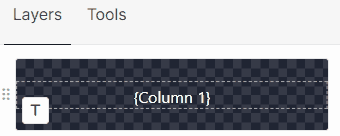

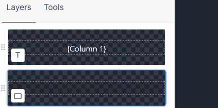

Working with layers
In the side pane of the Template Editor, the Layers tab offers an overview of all layers. Layers are used to make non-destructive edits by stacking icons, text, HTML content, rectangles, and ellipses one on top of the other without compromising the pixels of individual elements.
The benefits of working with layers:
  • You can add elements on top of each other without removing data.
  • You can apply conditions to only one layer of the template.
  • You can discard any layers you no longer need without affecting the entire template.
  • You can mask layers so that they are temporarily hidden without the need to delete them.

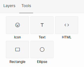

In the Tools tab, you can find an overview of available tools, each corresponding to a type of layer that can be added to your template. The following layer types are available:
  • Icon
  • Text
  • HTML (available from DataMiner 10.4.0 [CU14]/10.5.0 [CU2]/10.5.5 onwards)
  • Rectangle
  • Ellipse
Tools tab
The Template Editor in DataMiner 10.5.5

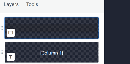

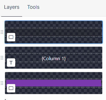

Changing the order of layers
If one layer is positioned higher than another, the higher layer will appear in front of the lower one. To change the order of layers, click the Drag-and-drop button and drag the layer up or down in the Layers tab. Release the mouse button when you reach the position where you want to place the selected layer.
Change order layers

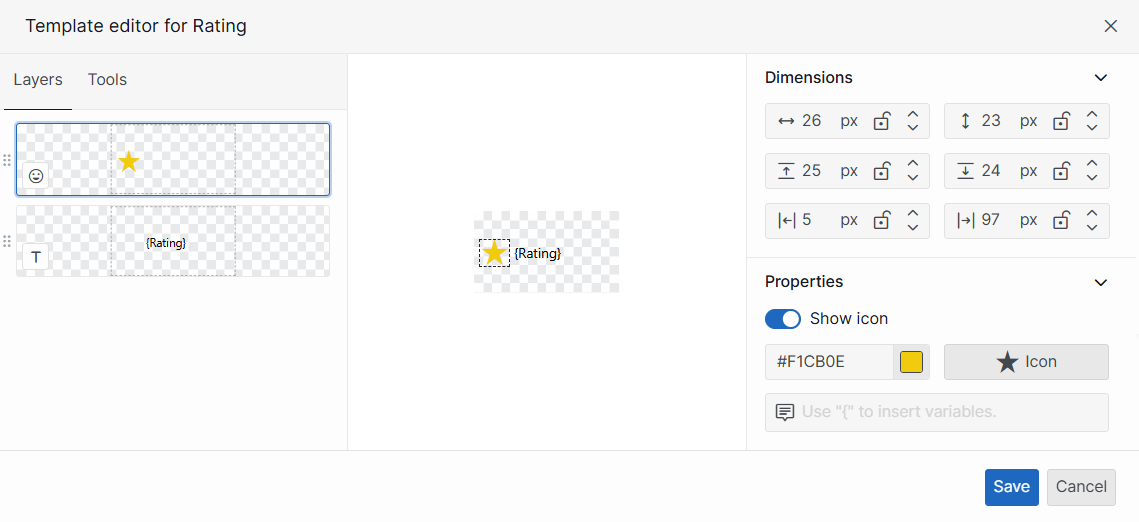

Changing template settings
With the Settings pane to the right side of the preview, you can change the settings for the entire template and the different layers. The preview is then immediately updated according to the changes.
  • To modify the template settings, make sure no layers are selected. In the Settings pane, you can specify the width and/or height of the template in pixels.
  • To modify the layer settings, make sure a layer is selected. In the Settings pane, you can adjust the following layer settings in three collapsible sections:
Resizing and positioning a layer
In the Dimensions section of the Settings pane, you can resize and position a layer:
Icon Setting Description
Width Width Specify the width of the layer (in pixels or percent). This value should be lower than or equal to the width of the overall template.
Height Height Specify the height of the layer (in pixels or percent). This value should be lower than or equal to the height of the overall template.
Top Top Specify the location of the top of the layer (in pixels or percent). This value should be lower than the height of the overall template.
Bottom Bottom Specify the location of the bottom of the layer (in pixels or percent). This value should be lower than the height of the overall template.
Left Left Specify the location of the left edge of the layer (in pixels or percent). This value should be lower than the width of the overall template.
Right Right Specify the location of the right edge of the layer (in pixels or percent). This value should be lower than the width of the overall template.
To change the unit used for the dimension values, click the unit itself. For instance, clicking px will switch to %.
You can secure one or multiple dimension settings of a layer by clicking the Lock icon next to the chosen setting. This lock functionality enhances the security of your design, preserving your template's intended appearance, especially when dealing with variable widths and heights. For example, when adjusting a table column width, you may want to maintain specific proportions. Once a setting is locked, any attempt to override the specified dimension will be restricted. This includes moving or resizing the layer in the preview and adjusting the component size in the dashboard or low-code app edit mode (e.g., changing the size of a table column). The locked dimensions ensure that the template remains in its designated position. If you are unable to lock a dimension setting because of the locking of other settings, the lock icon will be grayed out.
From DataMiner 10.4.0 [CU20]/10.5.0 [CU8]/10.5.11 onwards, it is also possible to lock a dimension setting of a shape to the virtual bounds of a component instead of the visual bounds. To do so, keep the CTRL button pressed while clicking the lock icon. The icon will then take the accent color (blue) to indicate that virtual bound locking is enabled. Functionally, this ensures that when virtualization is supported (e.g., in the timeline), shapes will align to the virtual boundary rather than the visible shape boundary, allowing them to extend outside the visible area (i.e., viewport). This way, time-based elements such as pre-roll and post-roll bars that extend beyond the viewport can be visualized.
  • In the preview, when you use the drag-and-drop functionality to move a layer, or when you resize a layer by dragging the frame edges, the dimension settings in the Settings pane will automatically be adjusted.
  • For some layers, the width and height is determined by the left and right position and can therefore not be modified.
  • Virtual bounds locking of the Width dimension is only possible when the unit is set to percent.

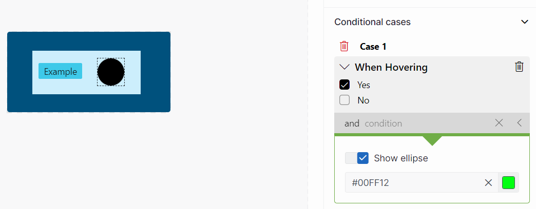

Adding conditional cases to a layer
You can make a layer respond dynamically to certain conditions, such as whether an item is selected or a specific column has a certain value. Conditional cases are defined in the Conditional cases section of the Settings pane.
Each case includes:
  • Conditions: Criteria that determine when the case applies.
  • Actions: What happens when the conditions are met (e.g., show or hide the layer, change styling, trigger events).
To configure a conditional case:
  1. Click Add case.
  2. Choose a state or a column from the dropdown list.
    • The available states:
      • Is selected: The action will be executed when a user selects the item.
      • Is busy: The action will be executed when the component is busy.
      • Hovering: The action will be executed when a user hovers the mouse pointer over the item.
    • When you have chosen a state, select Yes or No.
      • Yes: The action is only executed when the element is in the specified state.
      • No: The action is only executed when the element is not in the specified state.
    • When you have chosen a column, provide the necessary details based on the column type.
      For example:
      • Element name: The action is only executed when the element name matches this entry.
      • Parameter description: The action is only executed when the parameter description matches this entry.
      • Root time: The action is only executed when the current time aligns with the specified timestamp.
        • = dd/MM/yyyy hh:mm: The root time matches the specified timestamp.
        • > dd/MM/yyyy hh:mm: The root time occurs after the specified lower bound.
        • ≥ dd/MM/yyyy hh:mm: The root time occurs at or after the specified lower bound.
        • < dd/MM/yyyy hh:mm: The root time occurs before the specified upper bound.
        • ≤ dd/MM/yyyy hh:mm: The root time occurs at or before the specified upper bound.
  3. Optionally, add more conditions by clicking and condition and repeating the step above.
  4. Use the toggle next to Show [layer type] to control the layer's visibility when the conditions are met:
    • Enabled: The layer is shown.
    • Disabled: The layer is hidden.
  5. Define how the layer should behave when the conditions are met. You can customize the appearance of the layer or configure on-click actions that can be triggered when the conditions apply.
    • Styling options: Change the appearance of the layer, such as text color, background color, or size. The available options depend on the layer type and are the same as those listed in the Customizing layer appearance and behavior section.
    • Event actions: Click the Events button to configure an on-click action that can be executed when the conditions are met. Only available for DataMiner Low-Code Apps. For Text layers, this feature is only available from DataMiner 10.4.0 [CU14]/10.5.0 [CU2]/10.5.5 onwards.
    • Any visual changes made when configuring a conditional case will not show up in the preview.
    • From DataMiner 10.3.0 [CU12]/10.4.3 onwards, you can reset visual changes made when configuring a conditional case by clicking the reset button to the right of the option you want to reset. Prior to DataMiner 10.3.0 [CU12]/10.4.3, you can only reset custom text entered for a Text layer.
Example
This is a possible conditional case configuration:
Conditional case

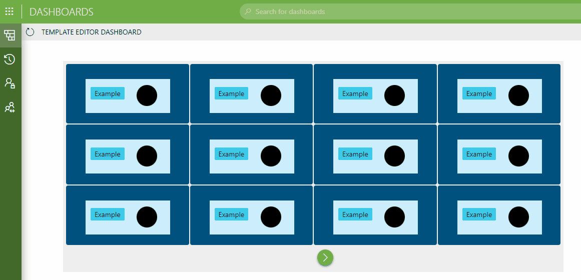

This is the behavior that will result from this configuration:
Conditional case behavior
Grid component in DataMiner 10.4.1

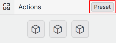

Using a preset template

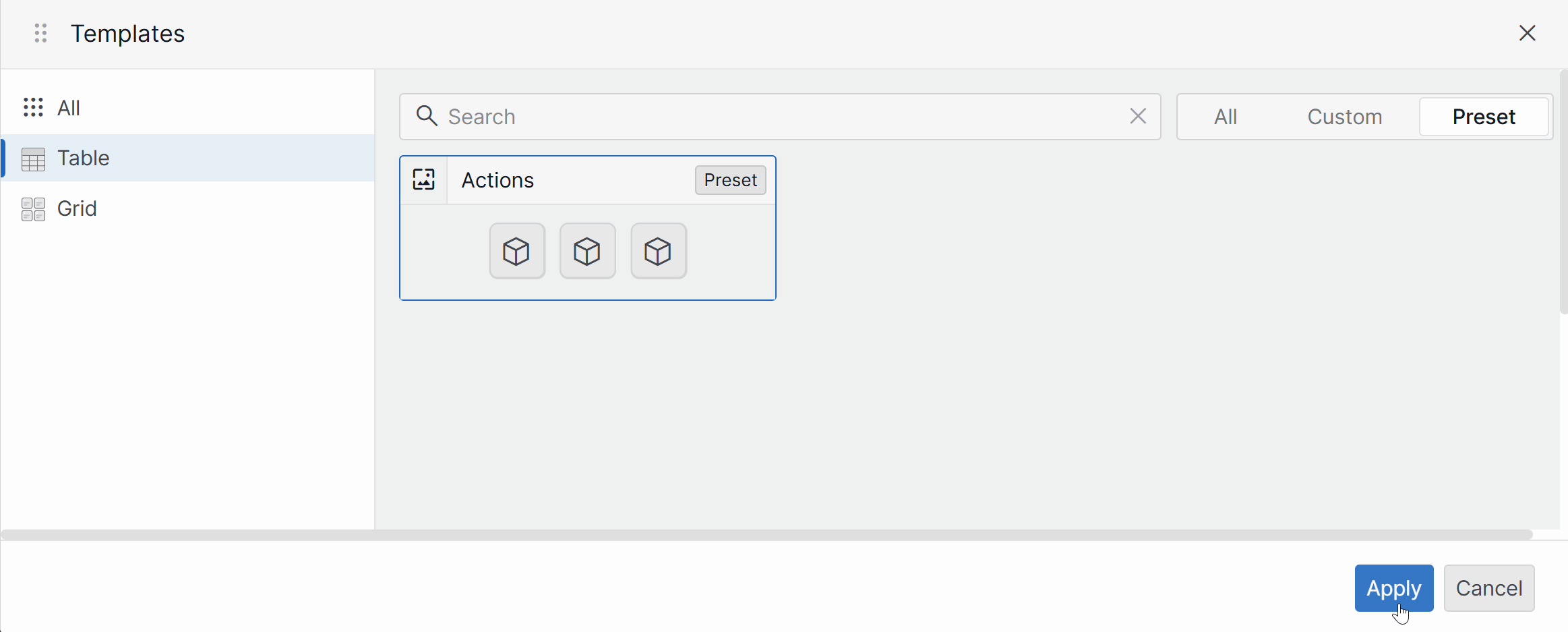

From DataMiner 10.5.0 [CU10]/10.6.1 onwards, you can start from a preset template when configuring a component that supports templates.
  1. Access the overview of available templates:
    • For the grid component:
      1. Select the grid component and go to the Layout pane on the right.
      2. Under Item templates, click Browse templates Browse templates.

          While you can access the template browser for timeline groups, no preset templates are available specifically for timeline groups yet.
    • For the table component:
      1. Select the component and go to the Layout pane on the right.
      2. In the Column appearance section, click the downward arrow next to Select a column and select the column you want to assign a template to.
      3. Click the Browse templates Browse templates icon.
        In DataMiner 10.5.0 [CU10]/10.6.1, first click the ellipsis button ("...") in the upper-right corner and then select Browse templates.
    • For the maps component:
      2. Under the Layer settings for a specific layer of the map, click Browse templates Browse templates in the Template section.
    • For the node edge graph component:
      1. Select the component and go to the Settings pane on the right.
      2. In the Identifiers section for the nodes, expand the Base node subsection.
      3. Make sure the Visual option is set to Template.
      4. Click the Browse templates Browse templates icon.
  2. Select a preset template from the overview. You can:
    • (1): Search for a template by name using the search box.
    • (2): Use the filter in the upper-right corner of the window to show preset templates, custom templates, or both.
    • (3): Filter the overview by visualization type using the options in the sidebar on the left.
    Preset template
    Template browser in DataMiner 10.6.4
    You can tell a preset template from a custom template by the Preset label in the upper-right corner of a template tile.
  3. Click Apply in the lower-right corner of the window.
    After applying the preset template, you can further configure it using the Template Editor.
Reusing a custom template
If you have already configured at least one other template for a component in the same dashboard or low-code app you are working on, you can reuse it for a second component that supports templates.
      1. Select the grid component and go the Layout pane on the right.
    • For the timeline component:
      1. Select the timeline component and go to the Layout pane on the right.
      2. Depending on what you want to customize, open the template browser in one of the following ways:
        • To browse templates for individual timeline items, click the Browse templates Browse templates icon in the Item templates section.
        • To browse templates for timeline groups, click the Browse templates Browse templates icon in the Groups > Template section. Available from DataMiner 10.5.0 [CU12]/10.6.3 onwards, when grouping is applied.
  2. Select a custom template from the overview. From DataMiner 10.5.0 [CU10]/10.6.1 onwards, you can:
    Preset template
Keep in mind that when you reuse templates, you may need to manually update column references: In a text layer of a template, you can enter a column name surrounded by curly brackets (for example, {CustomerName}) to insert the corresponding cell value into your text. However, when you reuse a template, these linked columns will not be automatically updated. If the component you are applying the template to has columns with different column IDs, you will need to manually update the column reference in the template to ensure the correct data is displayed.
Update template
Template Editor in DataMiner 10.6.4
