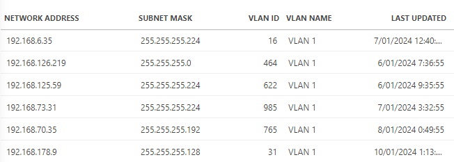

  1. Create a GQI query using the "IP subnets - Dummy" ad hoc data source.
  2. Add a GQI operator of type "Filter":
    1. Select the "VLAN Name" as the column to filter on.
    2. Select the "contains" filter method.
    3. Fill in the "VLAN 1" as the value for the filter.
  3. Visualize the result in a Table component.
    The result should look like this:

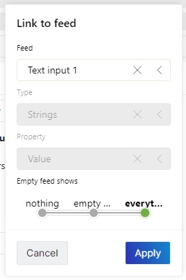

  2. In the Value box, click the "Link to feed" icon (or the "Link to data" icon in DataMiner 10.3.0 [CU21]/10.4.0 [CU9]/10.4.12 or higher).
    This icon is used everywhere a user can link a value to data.
    "Link to feed" icon in DataMiner 10.4.1
    Clicking the icon opens the Link to dialog, which will ask for a specific feed or data, the type, and a property.
  3. Specify the necessary info in the dialog:
    1. In the first box, select "Text input 1".
      You will notice that the type and property are automatically filled in if only one possible value is available.
    2. To determine what the behavior should be when the feed is empty, at the bottom of the dialog, select everything.
      This determines what will happen when the user does not fill in any value in the text input. Selecting everything ensures that all data is retrieved in this case.
      "Link to feed" configuration in DataMiner 10.4.1
      If you want the text input to behave like a search engine, you can select nothing instead. This will not retrieve any data until the user fills in a value in the text input.
