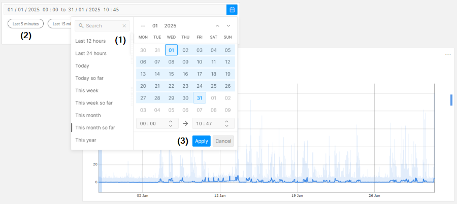

  • Presets (1): Presets are predefined time selections that allow you to quickly adjust the displayed time range without manually specifying start and end times. Examples include Last 2 days, Last 5 minutes, and Last year. You can access a list of presets by clicking the Calendar icon or the Clock icon (depending on your DataMiner version). From DataMiner 10.4.0 [CU12]/10.5.3 onwards, you can filter this list using the search box.
    Prior to DataMiner 10.4.0 [CU12]/10.5.3, if you use a sliding window preset like Last 15 minutes and filter another component, the data will dynamically update. As a result, the time range shown in the time range component may not match the one used in the linked component, unless the Allow refresh setting is enabled and the refresh rate is set to at least once per minute.

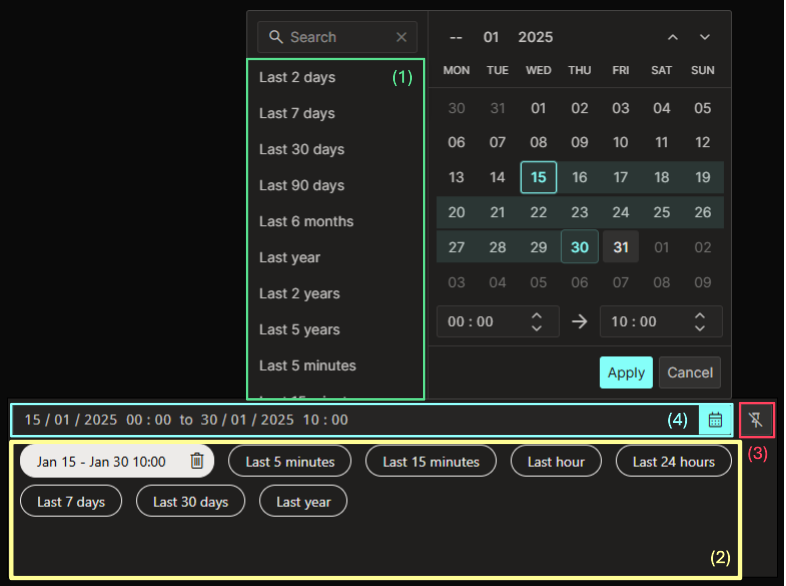

  • Quick picks (2): Quick pick buttons are presets that can be added as fixed buttons to the time range component for quick access to frequently used time ranges. You can enable the Use quick picks option in the Layout pane, where you can also configure which buttons to include.
  • Custom time range (3): You can manually set a custom time range by specifying a start and end time. If the Pinning as quick pick option is enabled in the Layout pane, you can save the time selection as a custom quick pick button.
    • From DataMiner 10.4.0 [CU12]/10.5.3 onwards, you can either enter a custom start and end time in the input box (in DD/MM/YYYY HH:MM or DD/MM/YYYY format, depending on the level of granularity) or click the Calendar icon to open the Calendar pane, where you can select the start and end time using the calendar interface.
    • Prior to DataMiner 10.4.0 [CU12]/10.5.3, click the Clock icon and specify the start and end time manually.
When you select a preset or quick pick, the time range will be updated immediately. If the time range is used as a filter, the component data will also update immediately. When you manually enter a custom time range in the input box, the data will be updated based on the Emit value on setting (Enter, Focus lost, or Value change). When you set a custom time range using the calendar interface or the custom time range editor (prior to DataMiner 10.4.0 [CU12]/10.5.3), the data will only be updated after you click the Apply button. If you have not yet clicked this button, you can revert any changes by clicking Cancel. Prior to DataMiner 10.3.0 [CU20]/10.4.0 [CU8]/10.4.11, the data is always updated immediately after the time range is changed.

    • Presets: Available from DataMiner 10.3.10/10.4.0 onwards. Allows you to customize the presets displayed when you select the component (1). The following presets are available: Still busy, In the past, Recently, Long run, Starting from now, Near future, and Distant future.
      Prior to DataMiner 10.3.10/10.4.0, the default presets include Still busy, In the past, Recently, and Long run. These presets cannot be edited.
    • Use quick picks: Determines whether the component includes quick pick buttons (2) that allow users to enter a preset time range by clicking a single button.
    • Pinning as quick pick: Available if Use quick picks is enabled. Displays a pin icon (3) next to the time summary in the component, which can be used to add the current time selection as a custom quick pick button. If the current time selection matches the custom quick pick button, clicking the pin icon again will remove the button. You can also remove the button using the garbage can icon on the button itself.
    • Show current range: Determines whether the current time range is displayed at the top of the component (4).

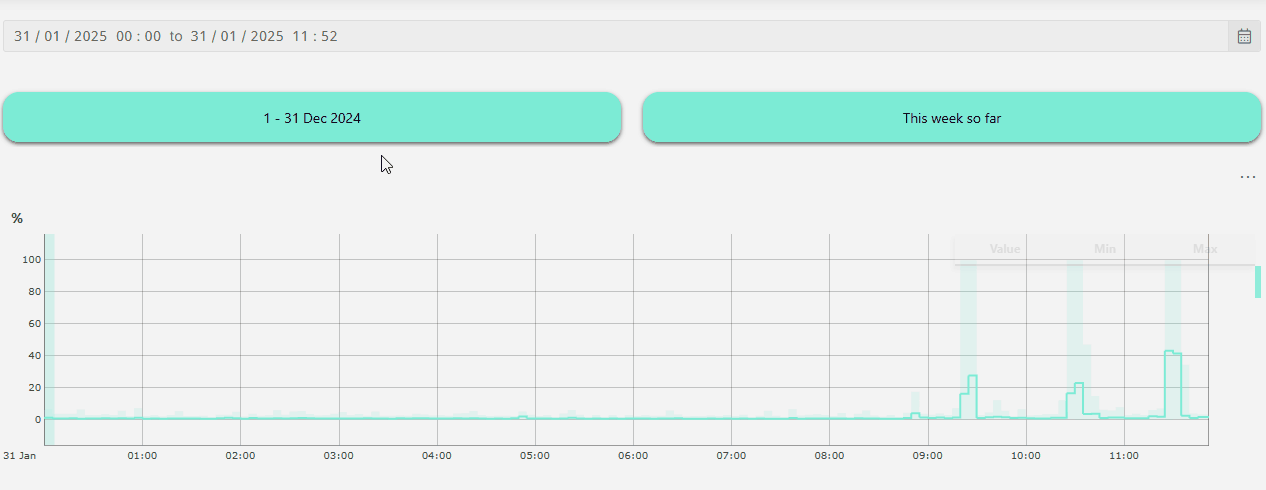

From DataMiner 10.3.0 [CU20]/10.4.0 [CU8]/10.4.11 onwards, when you have added a time range component to a low-code app, you can configure the following component action in your low-code app to interact with the component:
  • Set value: Allows you to set the current value of the component to a preset or custom time range.
    Example
    Time range, button, and line & area chart components in DataMiner 10.5.3
