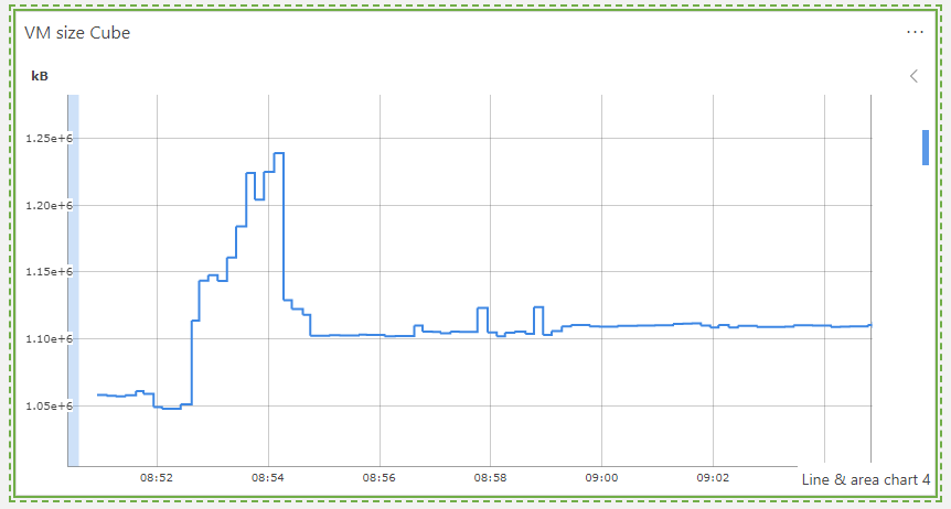

Line & area chart component in DataMiner 10.4.5

  5. In the Settings pane, in the Group by box, select Element. This way all KPIs will be shown in the same graph.
Example of a trend graph shown with a Line & area chart component
