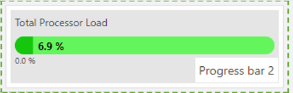

This component shows the value of one or more analog parameters with a progress bar.
Progress bar
Progress bar component in DataMiner 10.4.5
