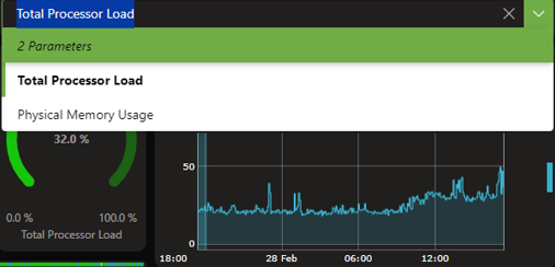

The parameter picker component allows you to select multiple parameters from a predefined list. At the top of the list, a box is available that allows you to select or deselect all items in the list at once.
Parameter picker component in DataMiner 10.4.5

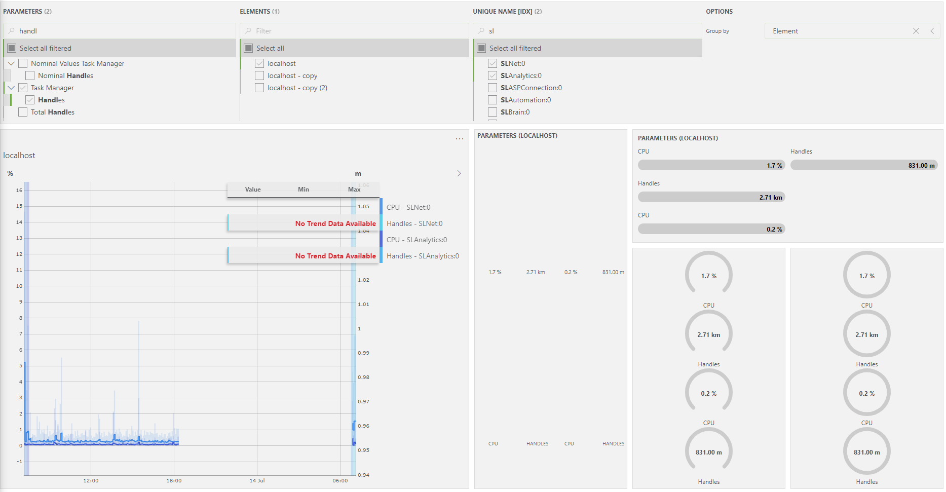

Default grouping: All together

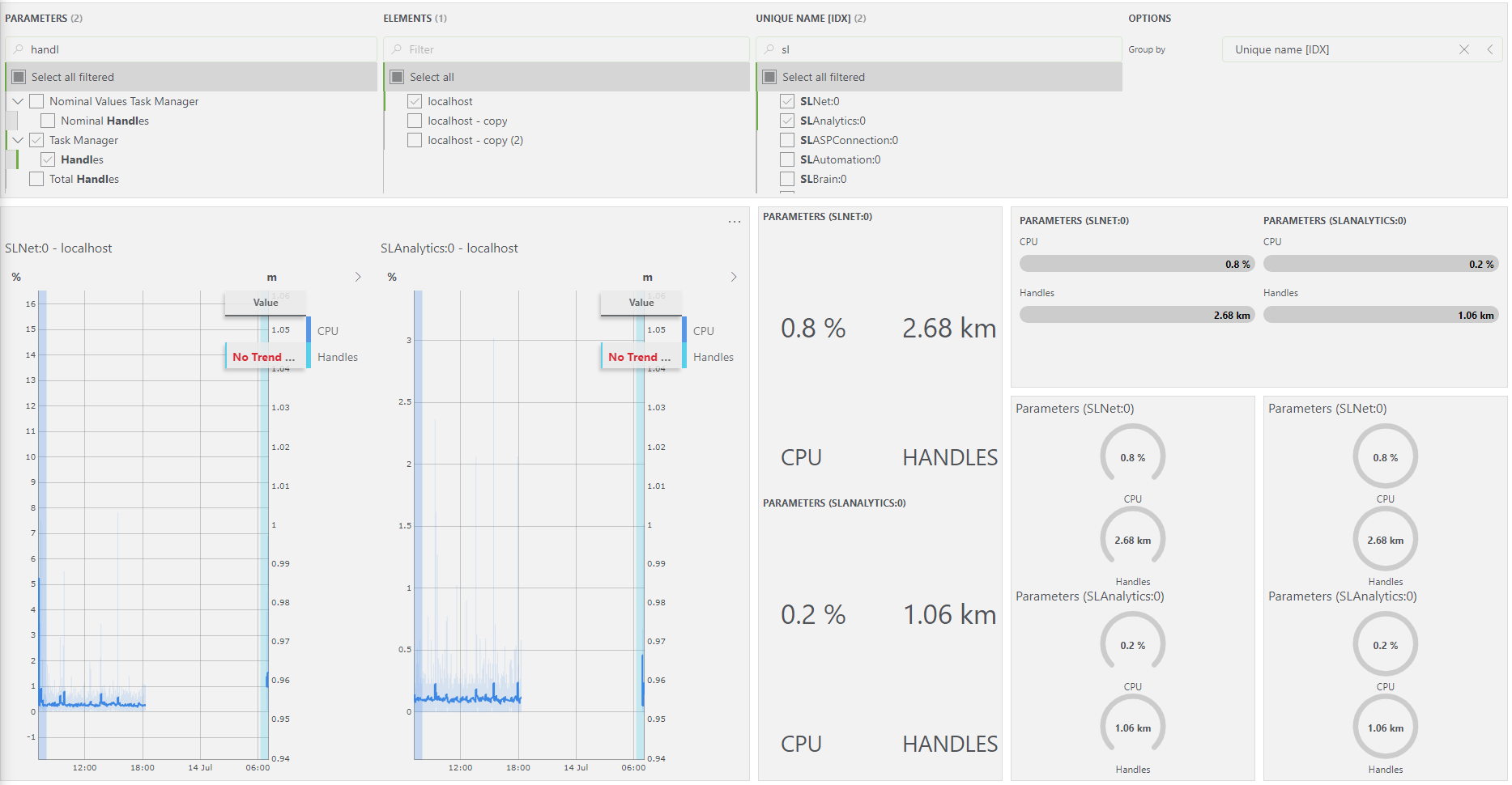

Default grouping: Parameter
Default grouping: Table index

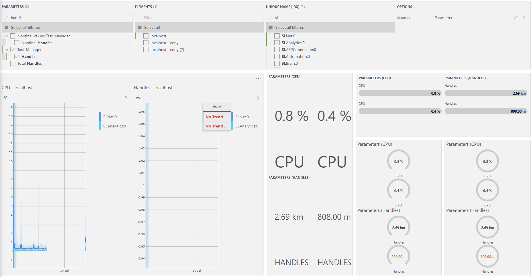

Default grouping: Element

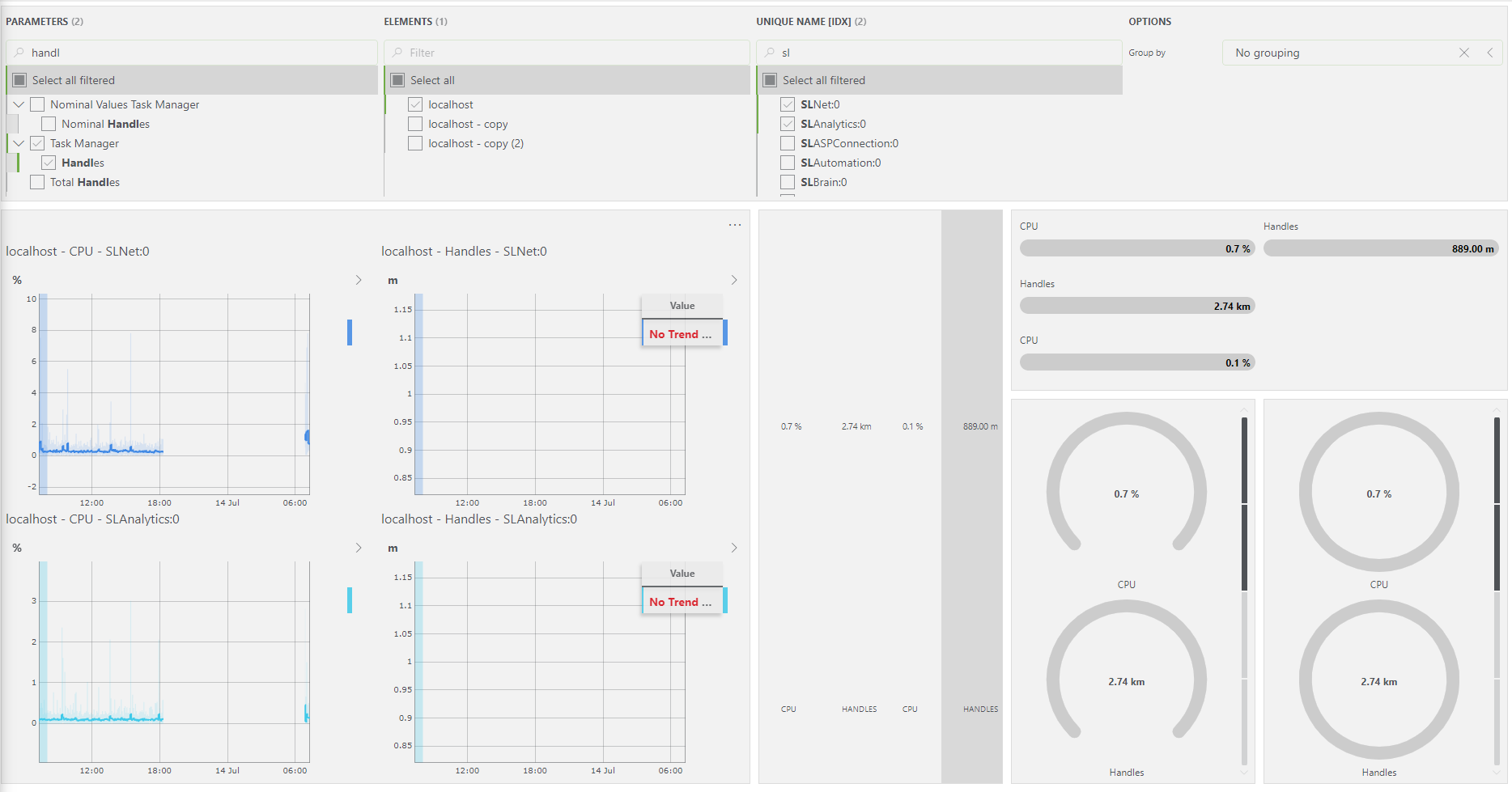

Default grouping: No grouping

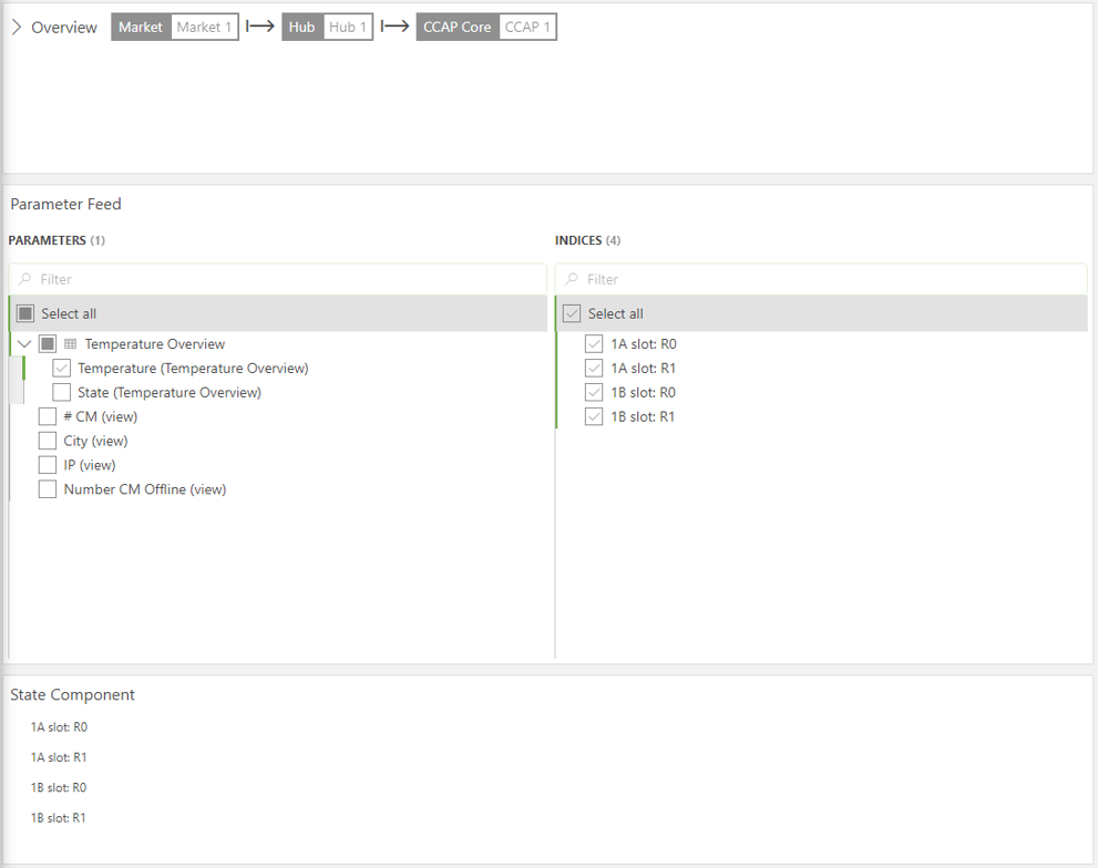

After selecting column parameter indices in a parameter picker, you can pass those selected indices to other components that support the same data.
In the Parameter Picker window, select the checkboxes in front of the parameters you wish to include.
Available indices will appear under Indices.
Select the checkboxes in front of the indices you wish to include. For example:
In the Data pane, go to All available data > Components > [Page/Panel name] > Parameter picker > Selected items and drag Indices to the component of your choice.
