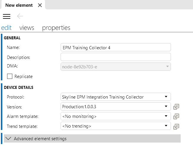

  1. Create a new collector element in the EPM Training view:

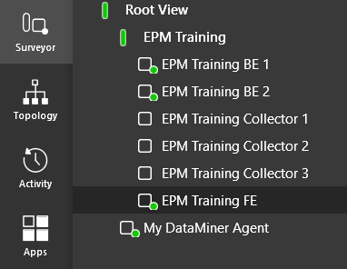

    1. Open the Surveyor in DataMiner Cube.
    2. Right-click the EPM Training view (e.g., the root view), and select New > Element.
    3. Enter the element name EPM Training Collector 4, select the DMA where the element should be added, select the Skyline EPM Integration Training Collector protocol, and click Create.
      If you are using a DMS consisting of multiple DMAs, select the same DMA as the one hosting the EPM Training BE 2 element. If you do not know which DMA is hosting this element, right-click this element and select Properties. The DMA ID is the first number in the ID, before the slash.
    Creation of new Collector element

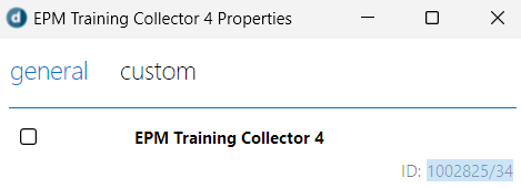

  2. Right-click the newly created element, select Properties, and copy the DMA ID/element ID of the element.
    DMA ID/element ID in element properties

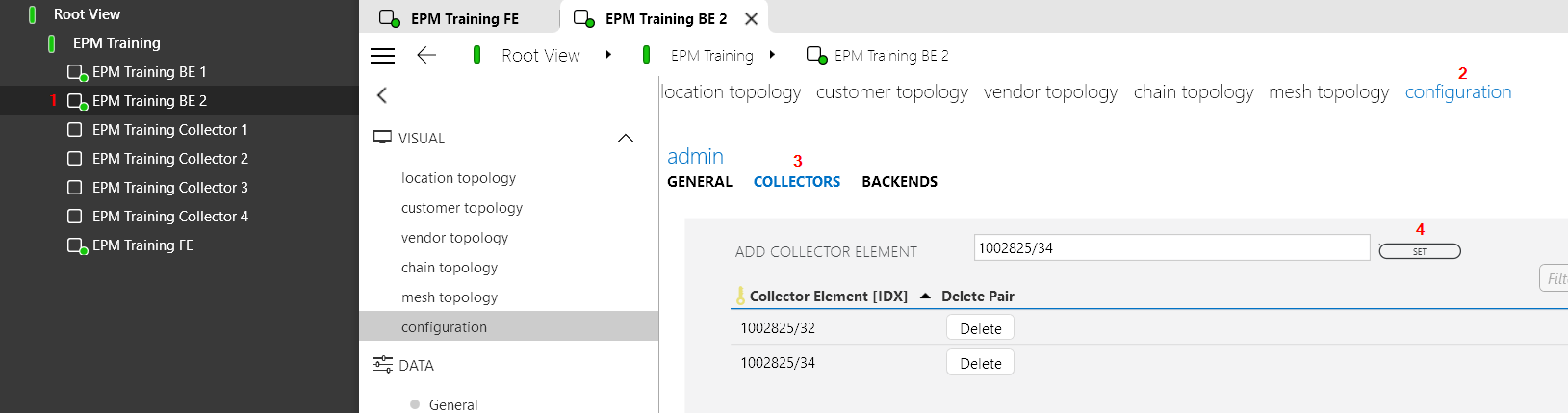

  3. Configure the EPM Training BE 2 element as the parent manager of the EPM Training Collector 4 element:
    1. Open the EPM Training BE 2 (1) element, and go to the Configuration visual page (2) and then the Collectors tab (3).
    2. Paste the DMA ID/element ID you copied earlier into the Add Collector Element box, and click SET (4).
    Collectors tab backend element

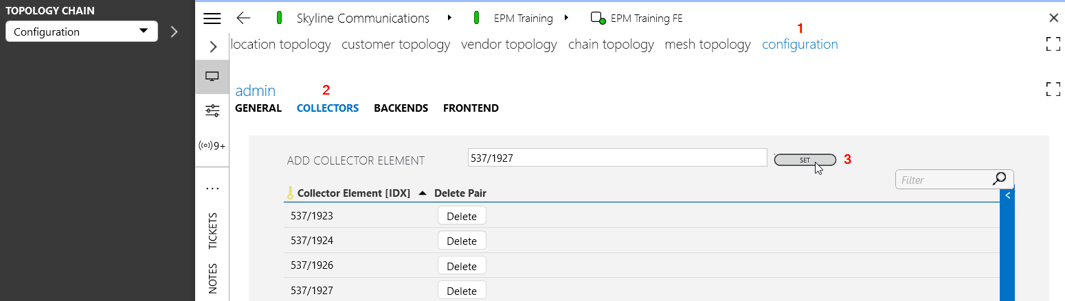

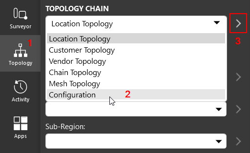

  4. Register the new element in the frontend configuration:
    1. Open the Topology app (1), select the Configuration topology chain (2), and click the ">" button (3).
      Topology chain
      This will open the Configuration visual page of the EPM frontend element.
    2. On the Configuration visual page (1), go the Collectors tab (2).
      Collectors tab frontend element
    3. Paste the DMA ID/element ID you copied earlier into the Add Collector Element box, and click SET (3).

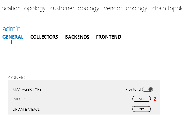

  5. Initiate the frontend provisioning cycle:
    1. Navigate to the General tab (1) of the EPM Training FE element.
    2. Next to Import, click the SET button (2).
    Import button on General page
    The Manager connector will now redistribute the load on the collectors, to prevent one element from having too much data.

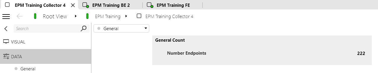

  6. To confirm whether this has been completed successfully, open the EPM Training Collector 4 element and check whether the Number Endpoints parameter on the General page is filled in.

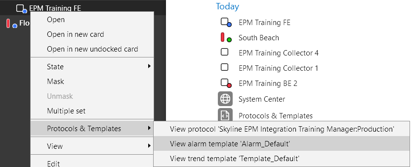

  1. Right-click the EPM Training FE element and select Protocols & Templates > View alarm template 'Alarm_Default'.
    This will open the alarm template assigned to the EPM Training FE element.
    Opening the alarm template from the context menu

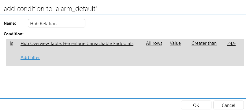

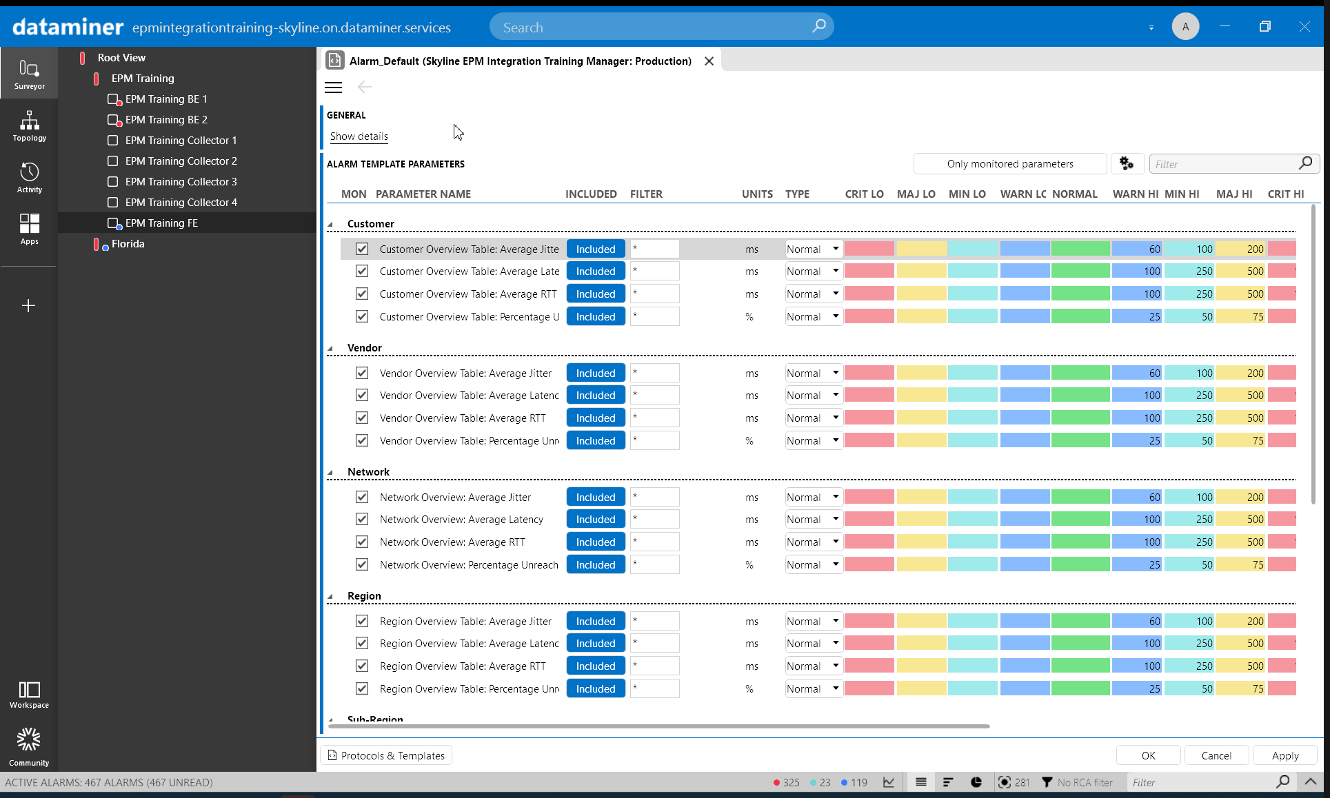

  2. In the alarm template, scroll down to the Station section and locate the Percentage Unreachable Endpoints parameter, then scroll to the right until you can see the Condition column.
  3. In the Condition column, click the row of the Percentage Unreachable Endpoints parameter, and select <New>.
    Adding a new condition
  4. Configure an alarm template condition to filter out any Station Unreachable Endpoints alarms when the parent hub is also in alarm for the same KPI:
    1. Name the condition Hub Relation.
    2. Click Select a filter and select the Hub Overview Table: Percentage Unreachable Endpoints parameter.
    3. Click Equal to and select Greater than instead.
    4. Click <Click to select> and enter the value 24.9.
    Alarm condition configuration
  5. Click OK to save the condition and OK again to save the alarm template.
With this configuration, if the parent hub has 25% or more unreachable endpoints, the station alarm will be ignored.

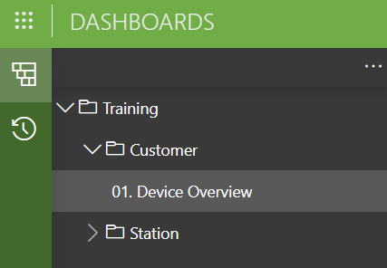

  3. Create a new dashboard in the new folder:
    1. Right-click the Customer folder and select Create dashboard.
    2. Enter the name 01. Device Overview and click Create.
    Device Overview folder

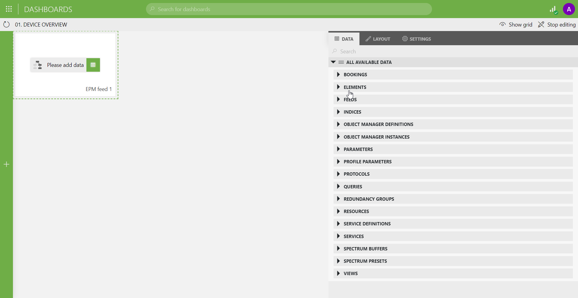

  4. Add an EPM feed component to the dashboard:
    1. Hover the mouse pointer over the sidebar on the left, so that the visualizations pane is shown.
    2. In the search box at the top, enter EPM.
    3. Click and drag the EPM feed visualization to the top of the dashboard.
    EPM feed component
  5. Link the component to the frontend element:
    1. In the Data pane on the right, expand the Elements item and select EPM Training FE.
    2. Drag the EPM Training FE item to the component you added earlier.
    Adding data to the EPM feed component

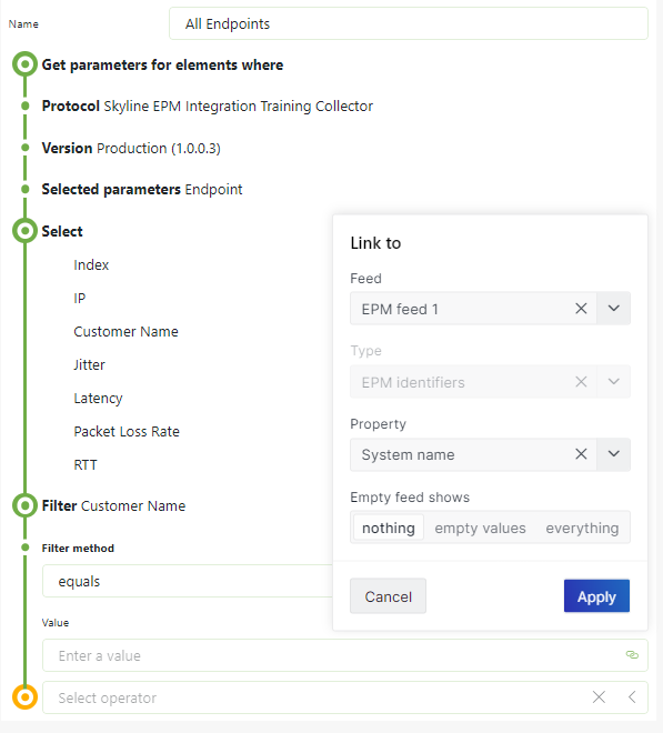

  8. Create a new query:
    1. In the Data pane, expand the Queries section and click the "+" button.
    2. Enter the name All Endpoints.
    3. Select the data source Get parameters for elements where.
    4. In the Type box, select Protocol.
    5. In the Protocol box, select Skyline EPM Integration Training Collector.
    6. In the Protocol Version box, select Production.
    7. In the list of parameters, select Endpoint to get the parameters from the Endpoint Overview Table.
    8. Below this, add the Select operator, so you will be able to select specific columns from the Endpoint Overview Table.
    9. Make sure only the following parameters are selected: Index, IP, Customer Name, Jitter, Latency, Packet Loss Rate, and RTT.
      At this point, the query will return all the endpoint information from all of the collectors.
    10. Select the Filter operator.
      With this additional operator, you will filter the results so only the endpoints associated with the customer selected in the EPM feed are returned.
    11. In the Column box, select Customer Name.
    12. In the Filter method box, select equals.
    13. In the Value, click the link icon on the right, select EPM Feed 1 in the Feed box and System name in the Property box, and click Apply.
    At this point, your query should look like this:
    Query configuration

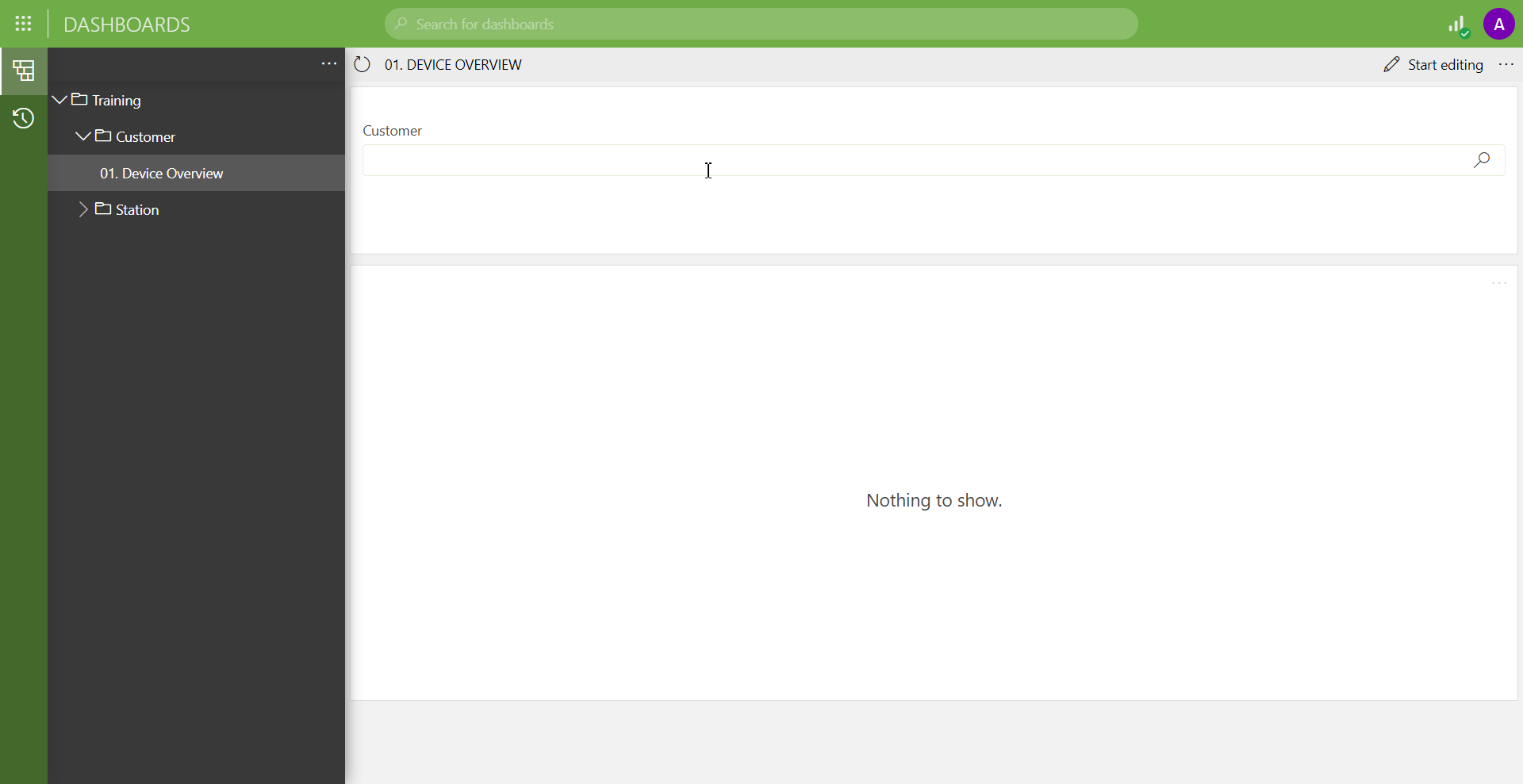

  12. In the upper-right corner, click Stop editing.
    Your dashboard should now look similar to this:
    Stretched out table component
  13. To test the dashboard, select a customer in the EPM feed, and check if the table below is updated to show all the endpoints associated with the selected customer.
    Selecting a customer in the EPM feed

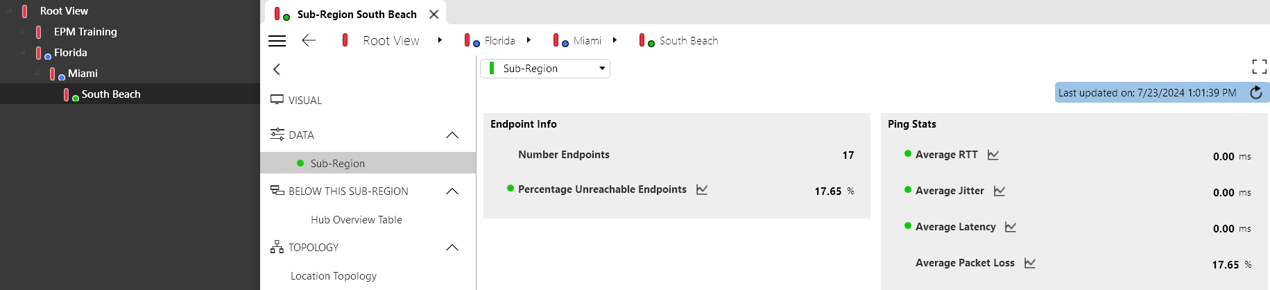

  1. In DataMiner Cube, add several new views to create a tree structure showing the relationships between specific locations:
    1. In the Surveyor, right-click the root view and select New > View, then name the new view Florida.
    2. Right-click the view Florida and select New > View, then name the new view Miami.
    3. In the same way, add the new view South Beach to the view Miami.
    South Beach view

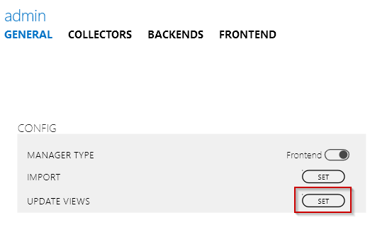

  2. Update the views in the frontend element:
    1. In the Topology app, select the Configuration topology chain, and click the ">" button.
    2. Next to Update Views, click the SET button.
      Update Views button
All the views will now be linked to their EPM objects and inherit their alarm properties from the EPM entity. Selecting any of the views will show a data section displaying the EPM KPI information.
Data section with EPM KPI information
