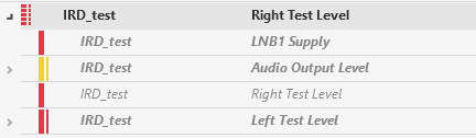

Correlated alarms
Correlated alarms are alarms triggered by the DataMiner Correlation module. They group other alarms based on a correlation rule.
You can expand a correlated alarm in order to see the base alarms that triggered the correlated alarm. By default, alarms are no longer shown in the Active Alarms tab when they are included in a correlated alarm.
The severity of a correlated alarm depends on the correlation rule configuration. It can be the highest severity of its base alarms or a custom severity.
Correlated alarms are represented in the Alarm Console with a special icon.
Correlated alarm
Correlated alarm in the Alarm Console in DataMiner 10.6.5
