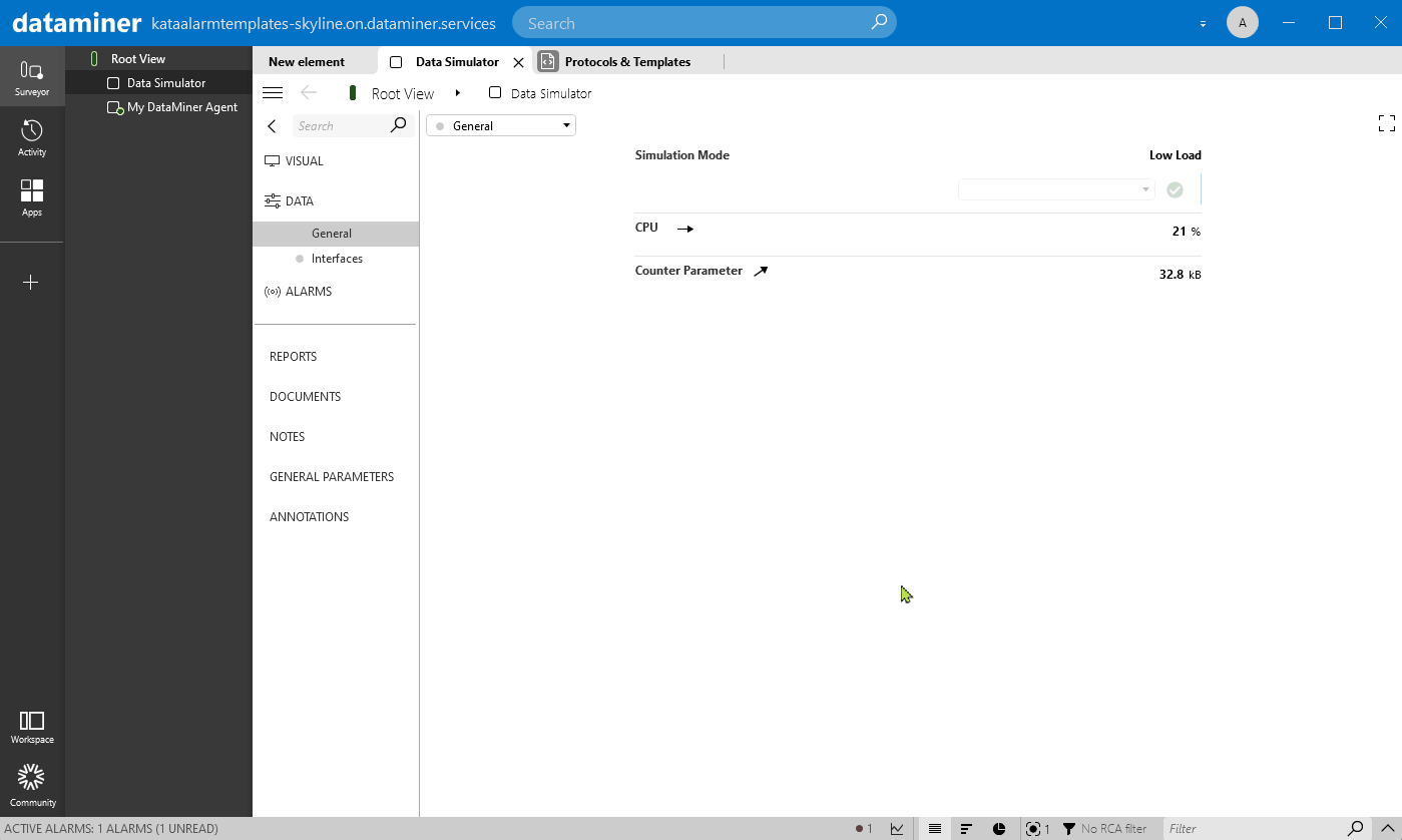

In the element, you should now see the alarm severity color displayed next to the CPU parameter on the General page.
Set Simulation Mode to a different value and check what happens.
The different modes simulate situations that can trigger alarms, so the alarm severity color next to CPU will change accordingly, and an alarm may be generated in the Alarm Console.

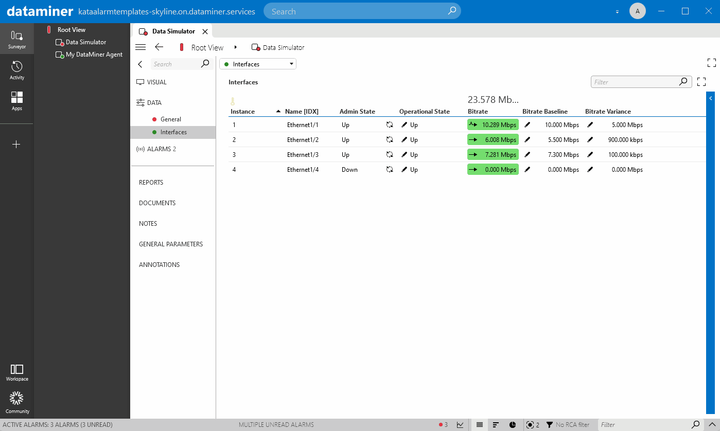

Step 5: Configure alarm monitoring using relative thresholds
With relative alarm thresholds, you can define a baseline from which the value can deviate percentage-wise. This can especially be useful for tables where every row can have a different baseline value.
Right-click the element in the Surveyor, and select Protocols & Templates > View alarm template 'Default'.
At the top of the template, click Only monitored parameters and select Only protocol parameters instead.
Select the Interfaces: Bitrate parameter.
In the Type box, select Relative.
In the CRIT LO and CRIT HI column, specify 20.
With this configuration, if the parameter decreases or increases by 20% compared to the baseline value, an alarm will be triggered.
In the NORMAL column, click [Baseline].
Right-click each cell in the Current value column, and select Use current value as baseline value.
The value that are currently in the table will now be considered the normal values to compare against.
With the Automatically update the baselines option at the bottom, the baseline values can be updated automatically based on the parameter history. However, you can only use this option if trending has been enabled on the parameter for at least the number of days mentioned in the Trend window box.
Click Close and then OK to save the changes.

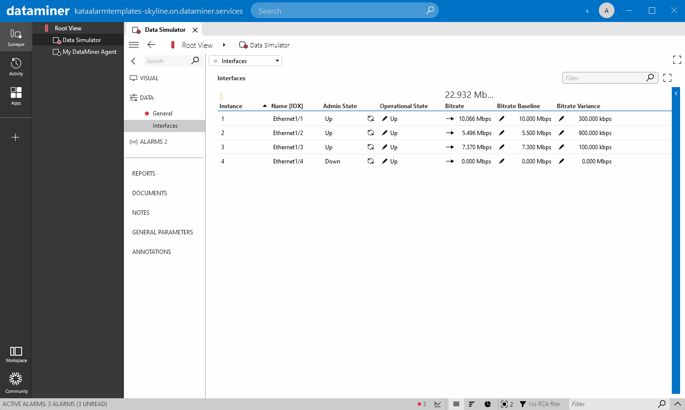

Go to the Interfaces data page of the simulation element.
You will see that the Bitrate column of the Interfaces table is colored according to the current alarm severity.
Change the values in the Bitrate Baseline and Bitrate Variance columns to simulate alarms.
Keep in mind that changing the Bitrate Baseline value will only change the behavior of the simulation. This will not change the baseline value of the alarm template.

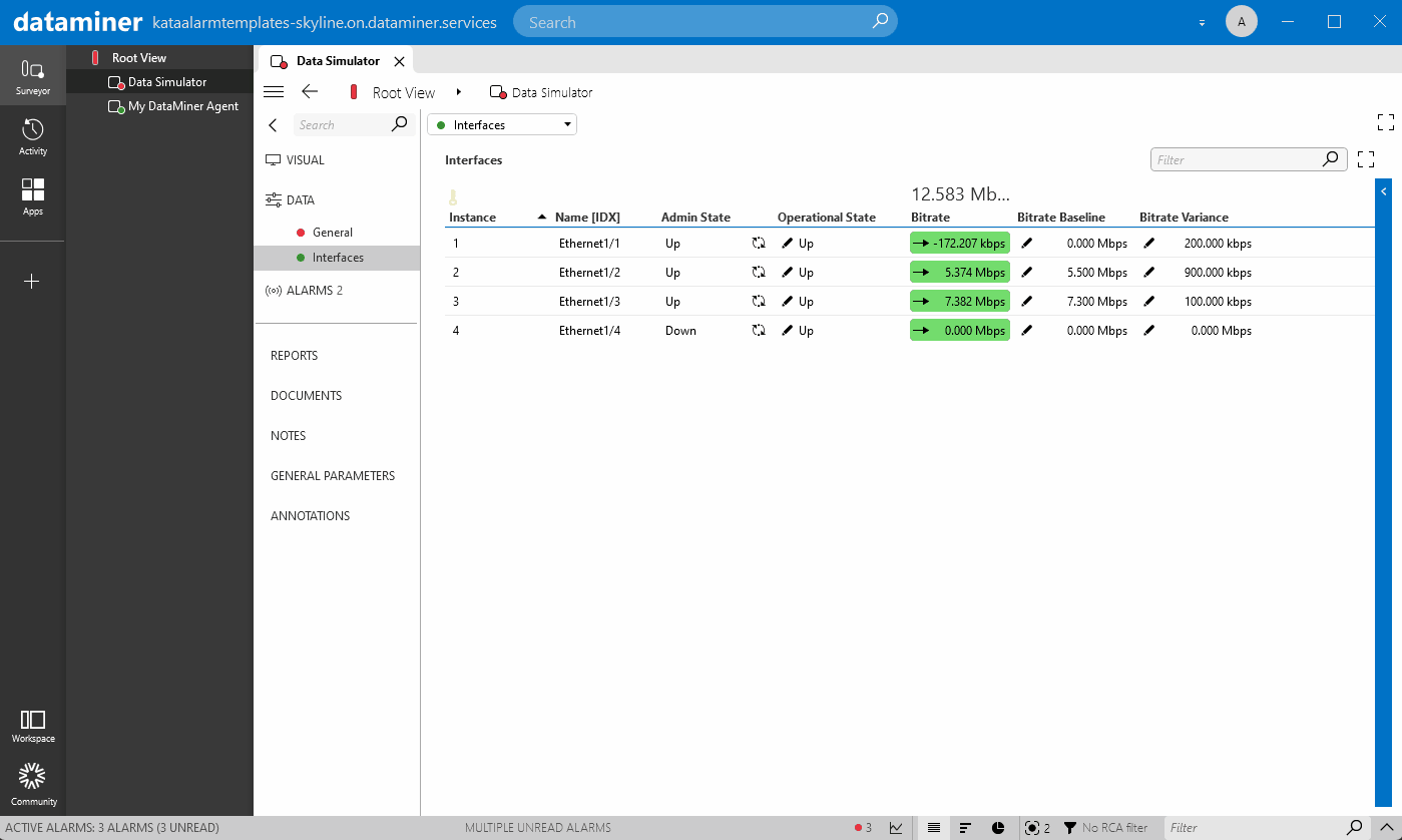

In some cases, it can be easier to define in absolute numbers how much a value can deviate from the baseline (e.g., when the baseline is close to zero).
Hover the mouse pointer over the Interfaces:Bitrate parameter, and click the + icon to duplicate the parameter.
In the filter box of the first instance of the duplicated parameter, specify the filter rule Ethernet1/1.
When you duplicate parameters in an alarm template and apply different monitoring based on filters, make sure that the most strict rule is always at the top, because the first rule for which a match is found will be used, and the rules below it will no longer be checked.
In the Type box, select Absolute.
In the CRIT LO and CRIT HI column, specify 0.5.
In the NORMAL column of the row with the Ethernet1/1 filter, click [Baseline].
In the Baseline value column for Ethernet1/1, set the value to 0.
In the Interfaces table of the simulation element, set the Bitrate Baseline value for Ethernet1/1 to 0, to simulate a bitrate fluctuating around 0.

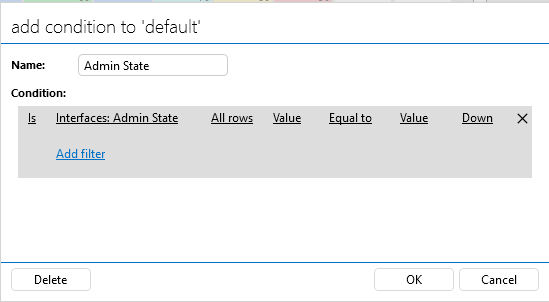

By defining alarm conditions, you can dynamically enable and disable alarm monitoring based on other values.
In the CONDITION column for the first Bitrate parameter instance, select <New>.
Configure the condition as illustrated below, and click OK:
Select the same condition for the other Bitrate parameter instance.
Click OK to save your changes.
In the Interfaces table of the simulation element, switch the Admin State for some interfaces to Down.
The alarm severity color should no longer be displayed for those interfaces.
