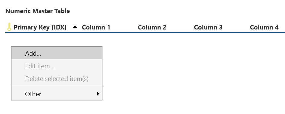

  4. Right-click below the table's column headers, and click Add to add a new row to the table.
    Add Row Numeric Table

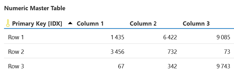

  5. Enter the row's primary key [IDX], enter random numbers into the first three columns, and click OK.
    Do not use any special characters for the primary key, as they will interfere with the URL linking later in this tutorial.
    Table input
  6. Add at least one more row to the table.
    Table rows

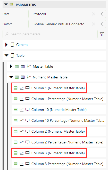

  6. From the Data pane on the right, add the necessary parameters:
    1. Expand the PARAMETERS section.
    2. Set From to "Protocol".
    3. Set Protocol to "Skyline Generic Virtual Connector".
    4. Use the filter to find the three numeric table parameters that you entered numbers for.
    5. Drag each of these parameters onto the Parameter feed component to be used as data.

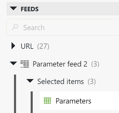

  10. From the Data pane on the right, add the Parameters feed:
    1. Expand the FEEDS section to find the items associated with the parameter feed.
    2. Expand the Parameter feed component.
    3. Drag the Parameters item onto the State component to be used as data.
    Feeds

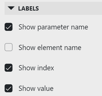

  11. In the Layout pane on the right, select the LABELS boxes to display the parameter name, the index, and the value.

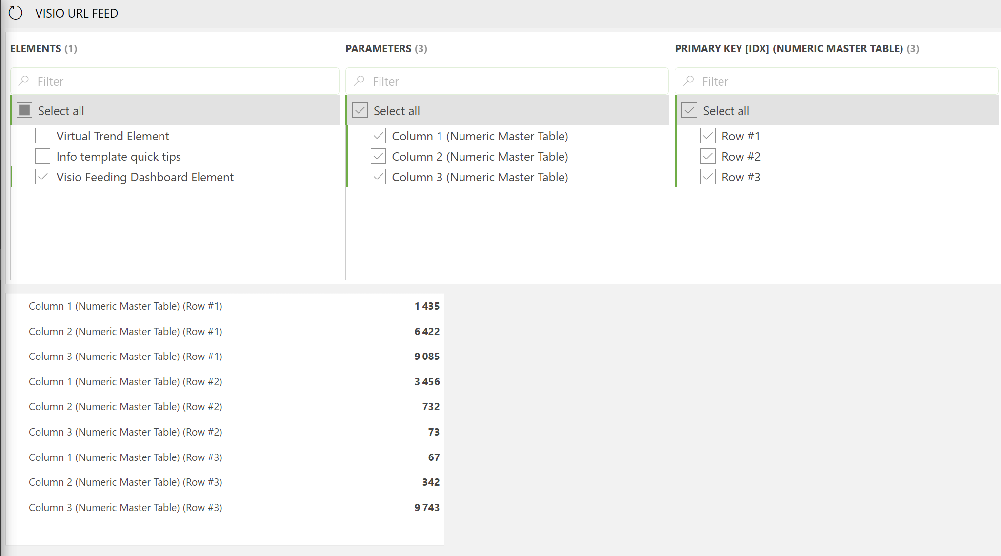

  12. Click Stop editing to exit edit mode.
    At this point, you should be able to make manual parameter feed selections to control which parameter values are shown on the State component.
    State component

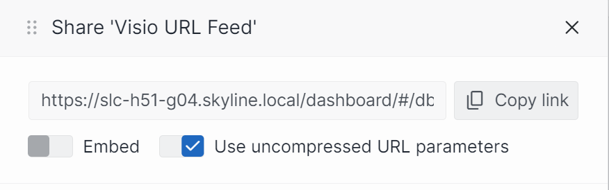

  13. In the top-right corner of the screen, click the ellipsis button, and then click Share.
    Share button
  14. In the pop-up window, enable the Use uncompressed URL parameters option, and then click Copy link.
    Pop-up window
    The URL you copied will be used later in this tutorial.

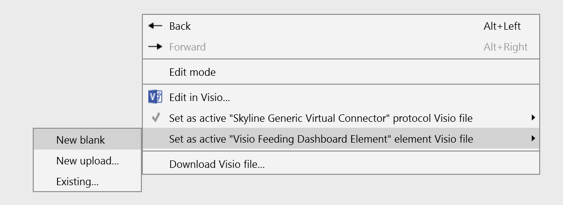

  2. Go to the VISUAL page of the element, and right-click anywhere to have the Visio file options displayed.
  3. Hover the mouse pointer over Set as active "..." element Visio file, and click New blank.
    New blank
  4. In the confirmation box, click Yes.
    A new Visio file associated with the element will now be created. It will look like a blank canvas on the VISUAL page of the element.

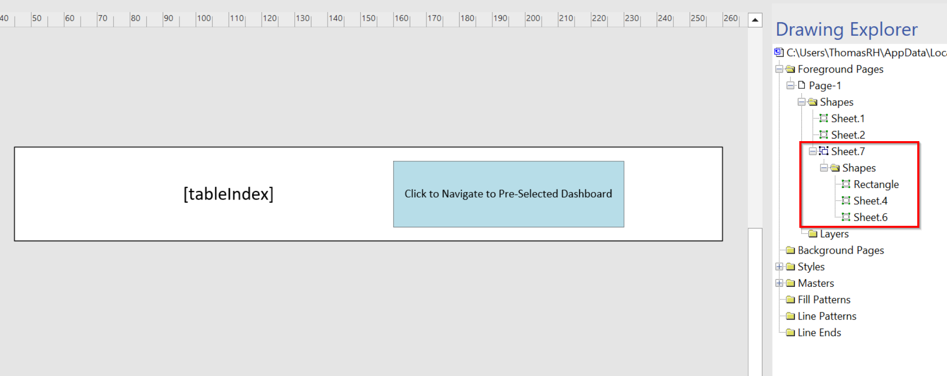

    You should see the following under the Drawing Explorer:
    Drawing Explorer
    If the Drawing Explorer is not automatically displayed, follow these steps:
    1. Right-click the ribbon and select Customize the Ribbon.
    2. In the Main Tabs list on the right, make sure Developer is enabled.
    3. Click OK in the lower-right corner.
    4. Access the Developer tab, and select the Drawing Explorer checkbox in the Show/Hide group.
      The Drawing Explorer window will become available in the corner of your drawing.

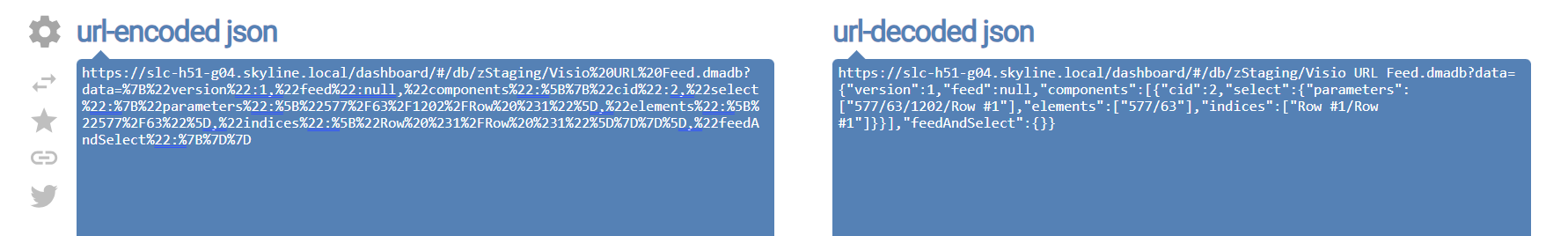

  13. Using a publicly available web-based encoded JSON URL converter, convert the URL you copied earlier to a human-readable format.
    This will make it easier to understand how feed selections are represented in the dashboard's URL.
    URL converter
  14. Replace sections of the URL with placeholders to allow dynamic entry based on the row index that is fed into it:
    http://<DMAIP>/dashboard/#/db/zStaging/Visio%20URL%20Feed.dmadb?data={"version":1,"feed":null,"components":[{"cid":2,"select":{"parameters":["[cardVar:_elementId]/1202/[tableIndex]","[cardVar:_elementId]/1203/[tableIndex]","[cardVar:_elementId]/1204/[tableIndex]"],"elements":["[cardVar:_elementId]"],"indices":["[tableIndex]/[displaytableIndex]"]}}],"feedAndSelect":{}}
    The first part of the URL (i.e. the part on the left of the question mark) needs to be changed to match the naming structure of your dashboard. The component ID (cid) also needs to be changed to match that of your parameter feed. You can find the ID of each component in the lower-right corner of the component while in edit mode.
  15. Again use a web-based encoded JSON URL converter, this time to convert the URL back to encoded JSON.
