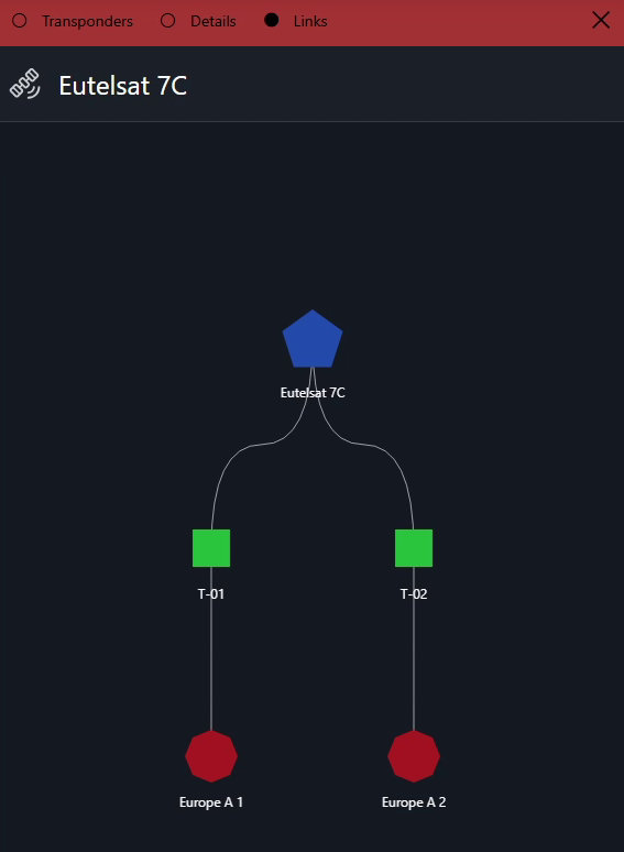

  • Visualize the satellite hierarchy (satellite, beams, transponders) in an interactive node edge graph.

The interactive node edge graph for the Eutelsat 7C satellite, showing the satellite node connected to its transponders (T-01 and T-02) and beams (Europe A 1 and Europe A 2)

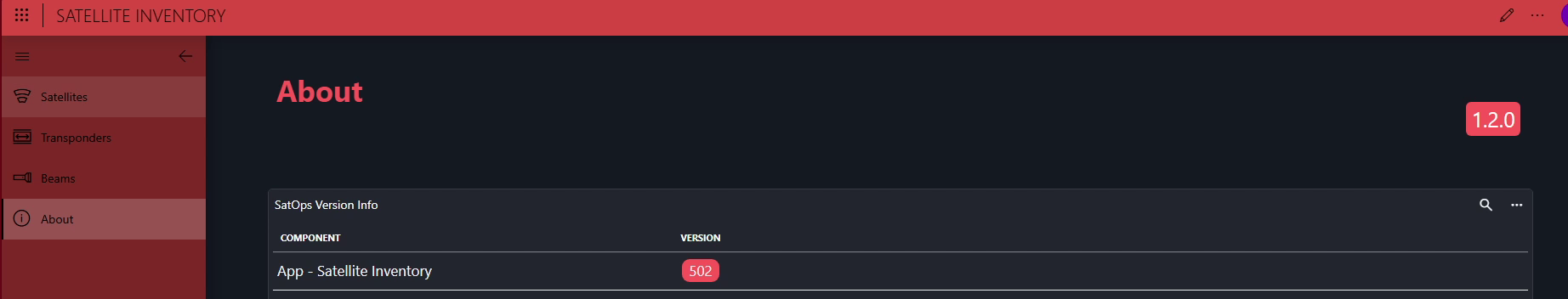

  • About: This pages shows the version of the app and the version of the SatOps Catalog package you are working with. This allows you to verify exactly which version of the standard solution you are using. At the bottom of the page, the Help button links to the official SatOps documentation on DataMiner Docs.
    The About page showing the app version and the SatOps package version
