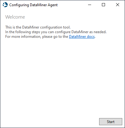

As soon as you log in to the VM, a window will be shown where you can configure your DataMiner System.
At this point, the DataMiner core software is fully installed. If you continue with the steps below, the Installer will also automatically take care of the license and data storage configuration. However, if you do not want a default installation, you may not want to use this automatic configuration:
- If you intend to restore a backup coming from another machine, for example, because of a hardware migration or during disaster recovery, skip the configuration below and follow the steps under Restoring a backup onto the new installed DataMiner Agent.
- If you are installing a Failover Agent, skip the configuration below, and follow the steps under Configuring the new DataMiner Agent as a new Agent in a Failover pair. These steps are the same as for an installation using the DataMiner Installer.
- If you accidentally close the configuration window, you can run it manually from
C:\Skyline DataMiner\Tools\FirstStartupChoice\FirstStartupChoice.exe. Make sure to run it with administrator privileges. - To configure DataMiner automatically without using the configuration window, see Unattended DataMiner installation.
Follow the steps below to configure your DataMiner Agent:
Click Next to get started.

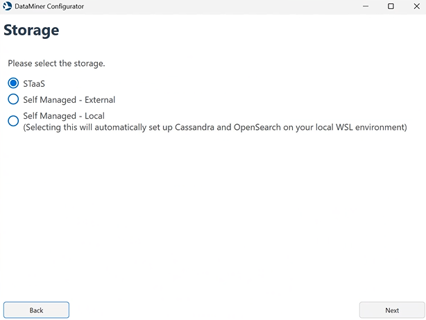

Select the desired database type:
Storage as a Service (STaaS) (recommended).
Self-hosted - External Storage: A regular dedicated clustered storage setup. If you select this option, you will also need to fill in the connection details for both Cassandra and OpenSearch.
Make sure these clusters are active and reachable from the VM you are setting up. You are responsible for the management of these external database clusters.
Self-hosted - Local storage: A clustered storage setup where both Cassandra and OpenSearch run locally on WSL. In this case, you will need to confirm that you have enabled nesting virtualization, as detailed above under Creating the VM.
This option should only be used for small-scale setups, for development, or for minimal deployments where STaaS is not an option. If you choose this option, make sure the necessary resources will be available for the WSL storage container. See Creating the VM.
If at some point you want to convert this setup to a larger-scale setup, you will need to either migrate to Storage as a Service (STaaS) or switch to using Cassandra and OpenSearch clusters on separate servers (not recommended), and then decommission WSL.

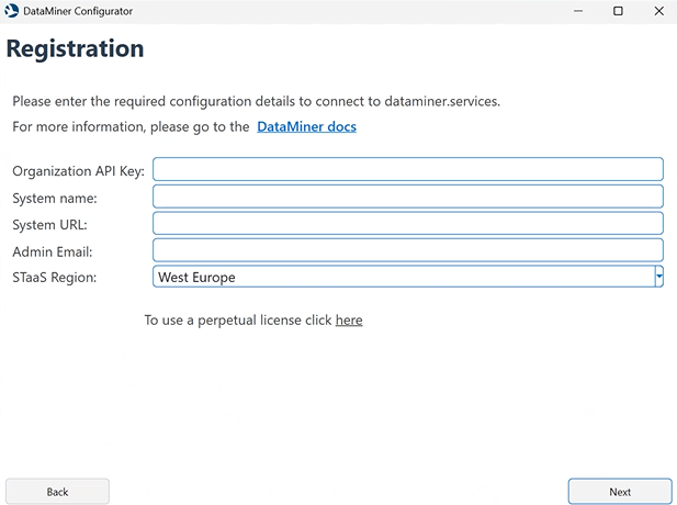

Click Next, and fill in the required details to connect your DataMiner Agent to dataminer.services:
- Organization API Key: Provide an organization key that has the necessary permissions to add DataMiner Systems in your organization. For more information on how you can add a new organization key to your organization on dataminer.services, see Managing dataminer.services keys.
- System Name: This name will be used to identify the DataMiner System in various dataminer.services applications.
- System URL: This URL will grant you remote access to your DataMiner System web applications. You can choose to either disable or enable this remote access feature at any time.
- Admin Email: This email address must be associated with a dataminer.services account that is a member of your organization. It will become the owner of the DMS on dataminer.services.
- STaaS Region: If you have selected to use STaaS for data storage, select the region where your data should be hosted.
Example with registration details for a STaaS setupNote

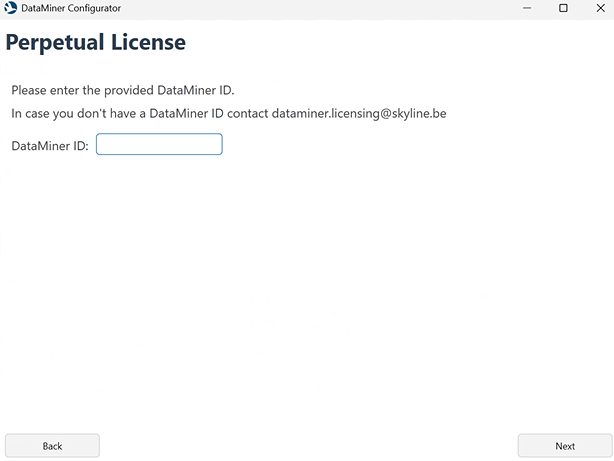

By default, if you install DataMiner while connected to the internet, DataMiner is deployed in subscription mode with a Community Edition license. However, if you want to do an offline installation or if you want to install DataMiner with a perpetual license, click the link below the registration fields and enter the DataMiner ID provided by Skyline. If you do not have a DataMiner ID yet, contact dataminer.licensing@skyline.be.
You can also deploy DataMiner in subscription mode first and switch to a perpetual license or switch to an offline demo license later.
